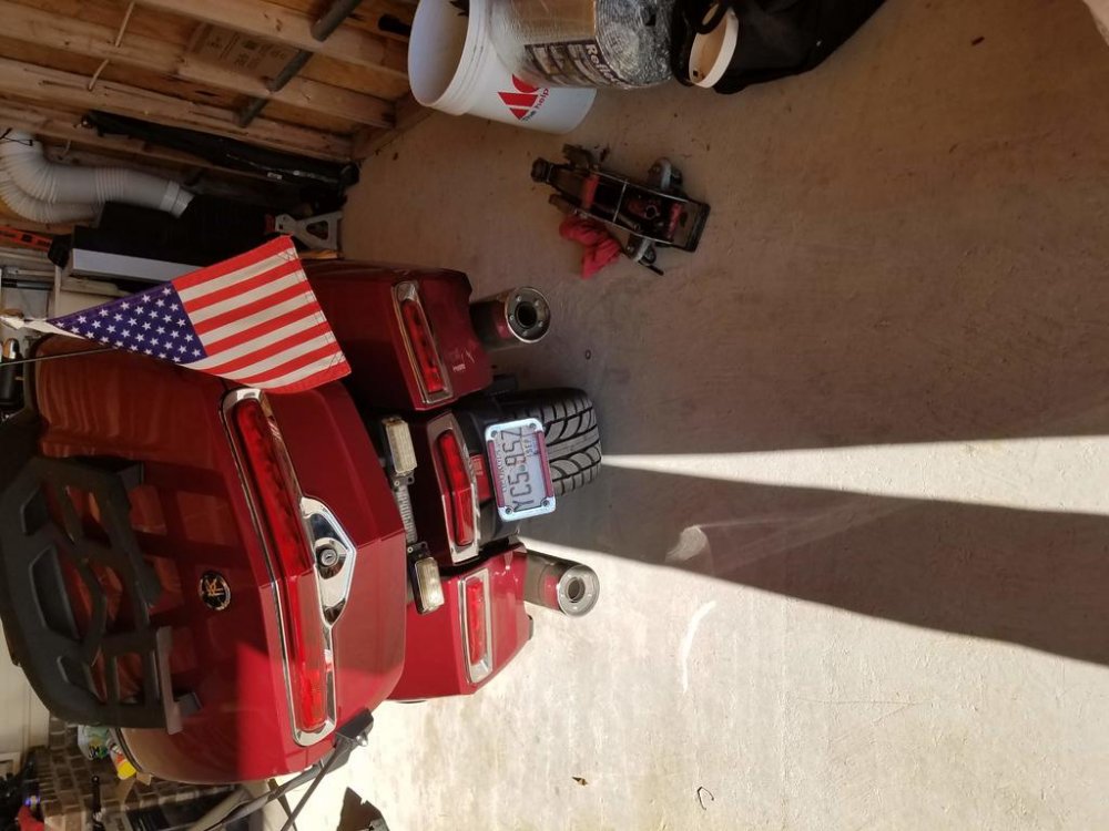

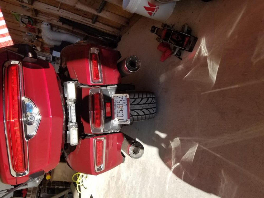

RonK Posted October 7, 2018 Author Share #29 Posted October 7, 2018 The phots are of his '18 SVTC, he has had older versions too -- I can't seem to locate the photos of the Venture with a bike tire on it. I can't seem to find it on the Facebook site. Regardless, the photo I saw somewhere was not of an '18 Venture but an earlier year. As each year phase is different, I don't know if the wider sectioned tires will fit on the '18. -- Link to comment Share on other sites More sharing options...
Freebird Posted October 8, 2018 Share #30 Posted October 8, 2018 (edited) The pictures posted here in this thread are of his '18 Star Venture. I can tell by the mufflers for one thing. Of course, the picture also shows the belt drive on the right side rather than the shaft drive on the left side as the '99 - '13 Royal Star Venture has. If the car tire is actually slightly taller than the stock motorcycle tire, then the little difference it makes on the speedo would be a good thing. So, as you state, what needs to be determined is whether or not the 205/55R16 will fit. These bike's speedometers, as will most Yamahas, actually show you to be going slightly faster than you really are. Yes, I have confirmed that with a GPS. On the '99 - '13 RSV, the speedo reads about 8% high. I haven't actually calculated the speedo no the '18 but I know that it reads at least a little faster than you are actually moving. I admit that .11 inch lower would probably be fine but it would further through the speedometer off, even though very slightly. The larger tire would be better all the way around it if will clear. Edited October 8, 2018 by Freebird Link to comment Share on other sites More sharing options...
RonK Posted October 8, 2018 Author Share #31 Posted October 8, 2018 The pictures posted here in this thread are of his '18 Star Venture. I can tell by the mufflers for one thing. Of course, the picture also shows the belt drive on the right side rather than the shaft drive on the left side as the '99 - '13 Royal Star Venture has. .... -- I don't think so. My Eluder doesn't look like that. The pictures of '18 Ventures don't look like that either. It's some other year bike. -- Link to comment Share on other sites More sharing options...

RonK Posted October 8, 2018 Author Share #44 Posted October 8, 2018 ... Maybe the picture looks different to you because of the mud flap but I actually compared it to my '18 and though I have a hitch on mine and can't get that exact angle, it is definitely a picture of the Star Venture. Like I said before, the mufflers are one clue and the fact that the drive pulley is on the right side is the second clue. I don't know of another large touring bike with the drive on the right side. Some of the Harley Sportsters do. That and the fact that he says it is a picture of the car tire on his 18 Star Venture. -- I believe that's it. I didn't realize there was a mudflap on it. -- Link to comment Share on other sites More sharing options...
