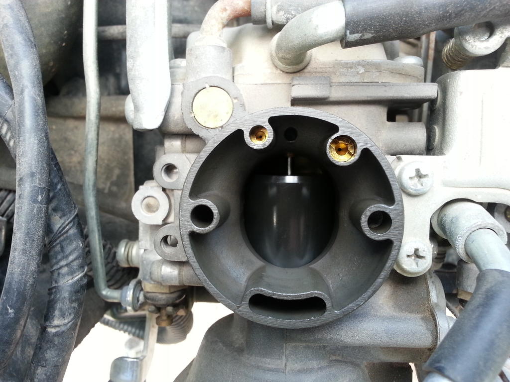

garyS-NJ Posted July 24, 2018 #9 Posted July 24, 2018 garyS-NJ said: I don't think air boxes are designed to create a restriction so much as to create dead air (a constant pressure) around a velocity stack which gets the proper air velocity past the jets. I put pic tubes inside my local pods on an old suzi with vm26 carbs and it helped immensely. I also partially shielded each pod with foil tape. Sent from my VS987 using TapatalkPvc pipe inside the pods Sent from my VS987 using Tapatalk
CaseyJ955 Posted July 24, 2018 #10 Posted July 24, 2018 garyS-NJ said: Are c.v. carbs more sensitive then old slide carbs like a mikuni vm26 Sent from my VS987 using Tapatalk It is my experience that they are notably more sensitive to restriction changes than flatsides. Upside is they seem better in adapting to altitude changes. The restrictors I'm referring to come as a set of four little brass cogs, smaller than a pencil eraser and with a specific sized orifice in each one. They slide into the second little port atop the carb adjacent to the barrel. They press right in by hand. I did it on my Vmax because I wanted to take advantage of the increased flow of a full Kerker 4-2-1 and a custom airbox with a big fat filter grafted to the top of it replacing the more restrictive inner filter. Other folks do it because a custom job requires removal of the factory airbox, for whatever reason the little brass restrictors are a neat clean cheap way to do it that does not require mods that would impede or hinder the flow of air into the carbs. http://www.morleysmuscle.com/ Sean is the guy to talk to if you need other options or more info on this one. He not only does Vmax but also has a couple very sweet Venture projects under his belt.

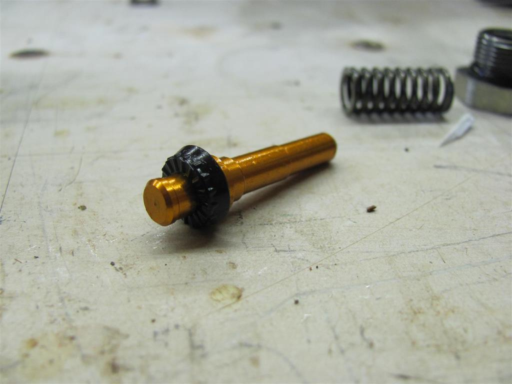

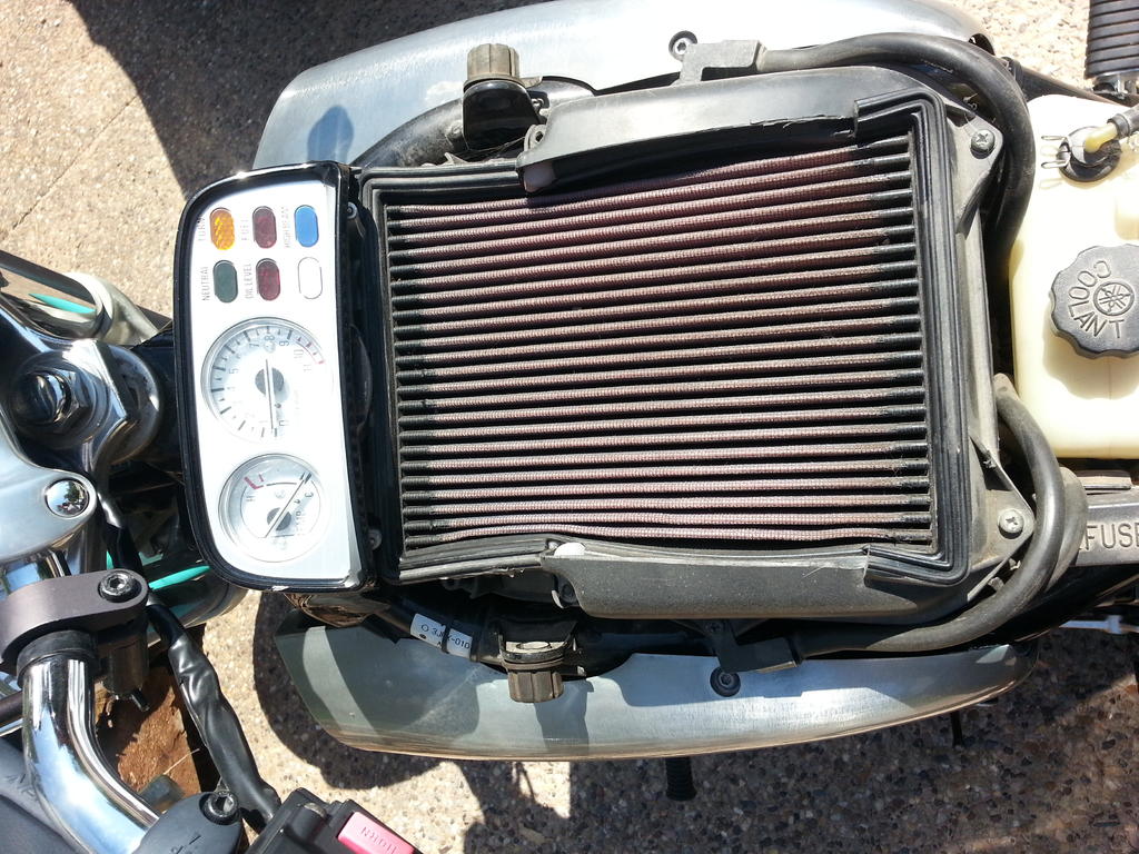

CaseyJ955 Posted August 6, 2018 #13 Posted August 6, 2018 I apologize for how long it took me to get this together as promised, its been an insane week, but here is a pic of my vmax carb with a restrictor installed, which allows proper operation with a free flowing filter system other than the OEM box. A pic of the custom high flow airbox lid that made the restrictors necessary, and a pic of the top of the carb. The brass jet can be seen, and the smaller brass dealio next to it is the restrictor.. Buy em, press em in and run any sort of airbox or pods you want. I hope this helps. Ill repost these pics and info in 1st gen tech so its searchable for others. The airbox lid is part of a jetting system created by someone that knows a bit more than I to take full advantage of the free flowing Kerker exhaust on the Vmax. Once I got her put together and the right jets instslled it was wild. Now it revs so easily and violently past redline that I will need to install a shift light/rev limiter. Im sure there is no performance gain for a Venture ( restrictive heads and exhaust) beyond being able to ditch the OEM airbox.
Prairiehammer Posted August 6, 2018 #14 Posted August 6, 2018 So basically, you are adding a custom sized "Main Air Jet" on top of the pressed in OEM Main Air Jet? Is there a size designation for this restrictor?

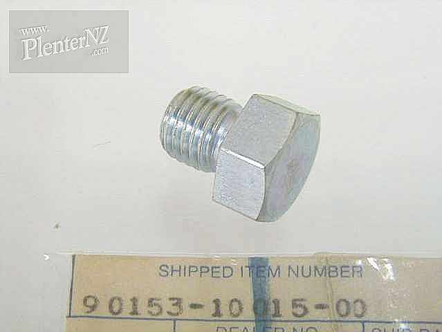

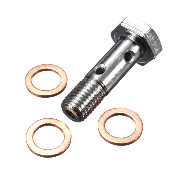

Prairiehammer Posted October 11, 2018 #18 Posted October 11, 2018 O.M.G. What are you doing to my bike? BTW, the banjo bolt in the rear brake reservoir was just a "plug" that I had on hand. It fit. It kept stuff out of the reservoir. Find an appropriate bolt/plug to replace it. Don't put too long of a bolt in there as a plug. And make sure to use a crush washer as a sealing "gasket". You may find that the stock front master cylinder is inadequate for use with two calipers. You will probably want to get a 1986-1993 (MKII) front master cylinder assembly to use instead of the 1983-1985 (MKI) front master cylinder. The MKI master cylinder has a ½" bore. The MKII master cylinder has a 14mm bore. Most find the ½" bore acting on the now four pistons does not deliver enough force nor does it give a good progressive brake "feel". Did you use a double banjo bolt (two orifices) at the front master cylinder? Also, you should have removed the proportioning valve from the rear master cylinder and attached the rear brake line directly to the rear master cylinder. Or at least gutted the proportioning valve, removing the inner workings.
