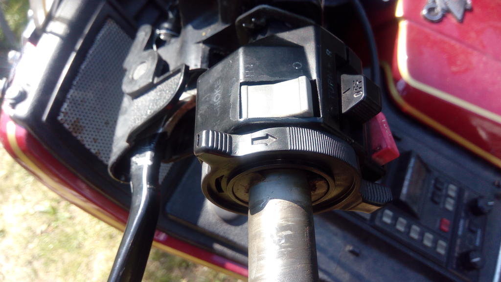

Arxvz1200 Posted July 18, 2018 Author Posted July 18, 2018 Thanks. I'll have a spare dash so I'll look into that. Regarding the switch removal I'm little stuck with not knowing how remove the choke (pic in the first post). I've learned to be extra careful with plastic bits. I bypassed the rlu the way described. Tie Green/Red + Blue/Black + Blue/White together. Tie Yellow/Green + Blue/Red together Tie Black + Light Green together" Hopefully I have some time later today. To look at the spare dash. I really appreciate the knowhow you guys have. I'll get back.
videoarizona Posted July 18, 2018 Posted July 18, 2018 Regarding choke: Take the switch apart. Should be a couple of screws underneath/behind and separate it from bars. I don't know if the choke is a part of the switch or separate like the throttle. I would think it would be separate and work just like the throttle...but I don't know. Just go slowly...it will make itself known as you go. If they are together, there maybe some screws inside the switch that will separate it from the electrical side.

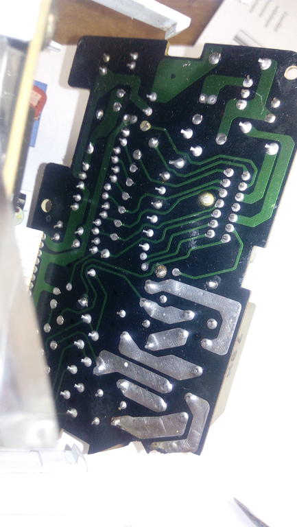

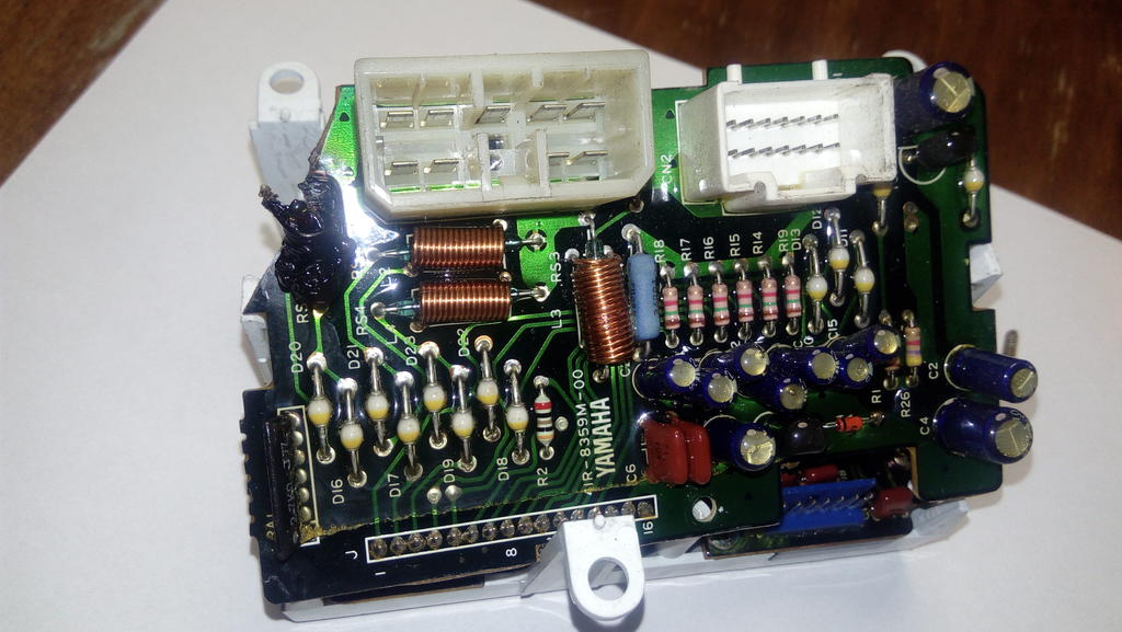

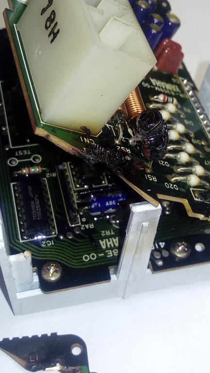

Arxvz1200 Posted July 20, 2018 Author Posted July 20, 2018 Well I just couldn't wait. I had to take a look. I opened to computer that is not in the bike, it's the one with no high beam function. Here are pics Even I can tell it's not as suppose to. This circuitboard/soldering stuff makes me feel little uncomfortable. I okay at carb cleaning, valve adjusting and etc timing, air/fuel mixture. But if so many people can do it I guess I have a chance of repairing this little corner. Other than that burned broken corner to me it looks ok. - has that part something to do with high beam ? - what is the part - how to repair ? - what else to inspect ?
Arxvz1200 Posted July 20, 2018 Author Posted July 20, 2018 It's the high beam in the corner http://www.venturerider.org/forum/showthread.php?92274-How-do-you-quot-Jumper-the-CMU-quot-for-LED-s-bulbs-to-prevent-the-warning-light-coming-on&highlight=jumpers I'm thinking of jumping high/low that way in the future I could update the lights in the future. the high beam thingy has burned and broken off. I need to figure where the other end of jumper wire needs to go. The connection is under the burned black stuff. Maybe I should use dremel to grind the burned stuff away ?

videoarizona Posted July 20, 2018 Posted July 20, 2018 (edited) Looks the same, but mine is safely on the other side of the world [/QUOT I know Anssi, But yours is only the 2nd choke setup like this I've seen. The picture was the first. I linked it so you could see the other pictures and maybe get get a clue as to how it comes apart... So, it looks like it's one piece...so you should be OK to take the unit off the handlebars. From the looks of one of the photos, the choke cable slips off. There must be another part of the choke that stays on the bars and holds the cable. Let us know how it goes.... Edited July 20, 2018 by videoarizona correction
Arxvz1200 Posted July 22, 2018 Author Posted July 22, 2018 Didn't know that choke is rare. I'll leave the switch as it is. Since the fault is the computer unit and scared of breaking something. I'll start another thread for computer rescue attempt. thans Anssi
