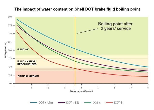

And you're correct about changing the fluid every 2 years, the reason for that recommendation is that it is impossible to prevent brake fluid, which is hydroscopic at a molecular level, from absorbing moisture from the air and the more moisture, the lower the boiling point. Brake fluid will absorb moisture through the pores of rubber brake lines and the seams in the system, its that hydroscopic. I know that sounds crazy but its true. It wants moisture, it needs moisture, it will get moisture. This is the reason for the 2 year change recommendation, that's how long it's estimated to take for a sealed system that hasn't been opened to absorb enough moisture from the atmosphere to compromise the fluid. Leave the system open for 15 minutes so you can pour in fluid while bleeding the system and you've taken 25% off the life of your fluid. 30 minutes, 50%. Less of course if you're in a high humidity area. Take the top off your master and leave it overnight, you've just ruined your fluid. Really. It will still work the brakes, but its corrosion preventative abilities and thus its heat resistance are gone. Here's a chart I stole from someone on the net, notice that the title is "The Impact of Water Content ..." -
