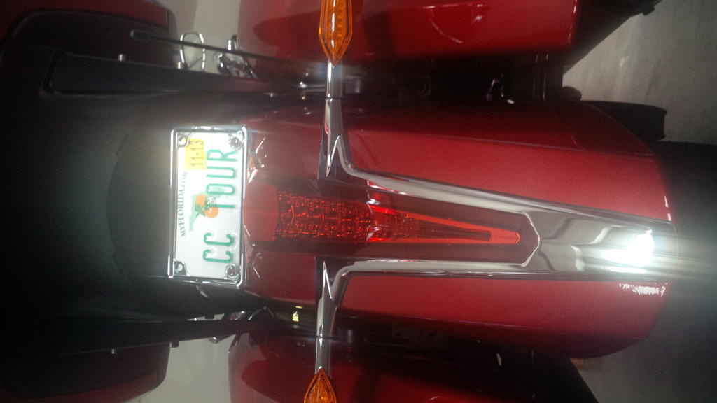

If you want a photo of my old Victory your out of luck as I no longer hav any photos of the bike out side of a rear shot showing the tag.
I can't believe you threw out old pictures of motorcycles you have had. Ex-wives well okay, but not bikes.
