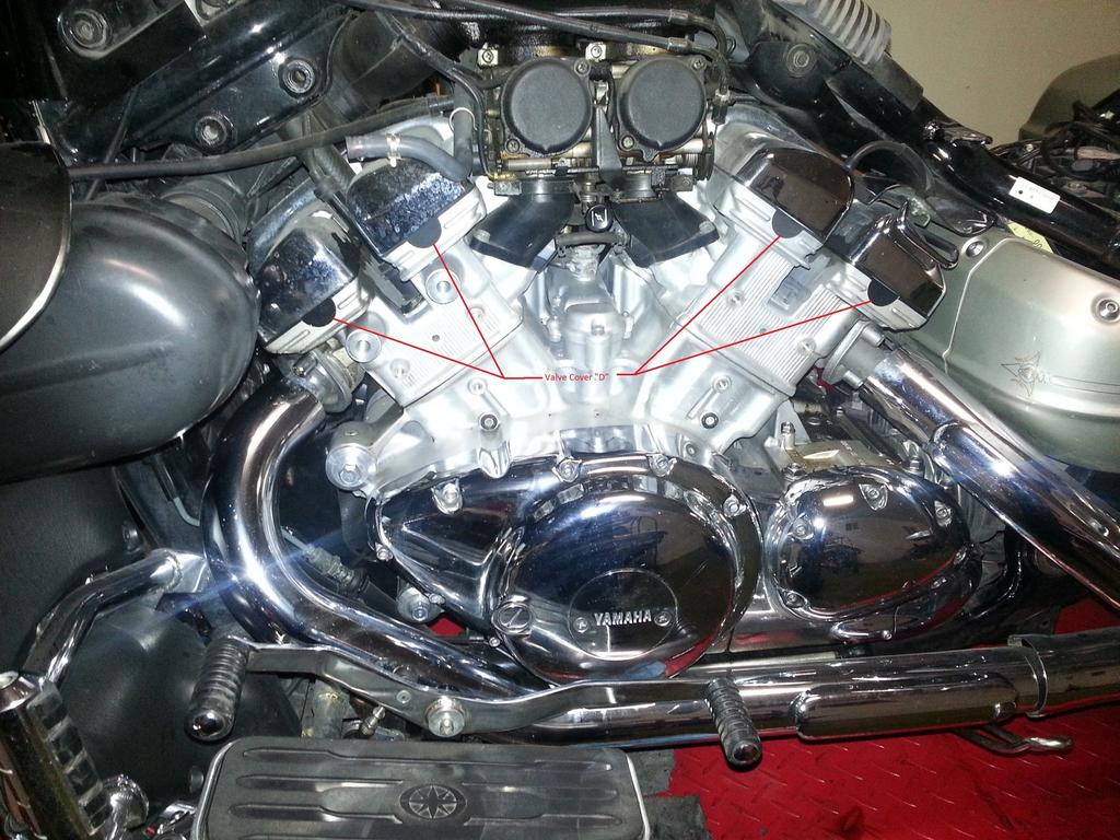

Patmac6075 Posted October 3, 2016 Posted October 3, 2016 I'll have to admit....I have no idea what valve cover Ds are? I know what the valve covers are, I know what the valve cover gaskets are, I know what the valve cover bolts are, and I can only assume we're talking about the rubber hold down washers? I've heard them called donuts and pressure washers, but not Ds....is this what we're talking about?
BratmanXj Posted October 3, 2016 Posted October 3, 2016 I'll have to admit....I have no idea what valve cover Ds are?
Patmac6075 Posted October 3, 2016 Posted October 3, 2016 A picture is worth a thousand words! thank you
Flyinfool Posted October 3, 2016 Posted October 3, 2016 The "D"s are the first place an old gasket will start to leak as the old rubber gets hard and starts to shrink.
