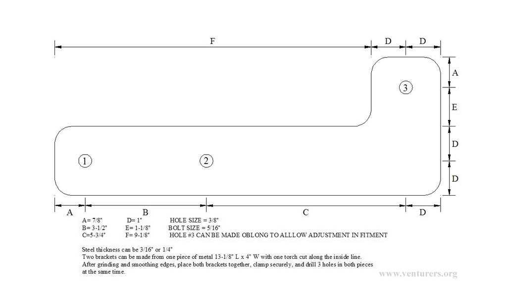

uechi kid Posted August 12, 2016 Author Posted August 12, 2016 I received the new mufflers the other day and when I opened up the box there was no hardware. That's being taken care of by the seller. While I was waiting for the mufflers to get here i made a template for the mounting bracket from a drawing I found on the internet, it's probably here too. Lining the template up with the bracket welded to the mufflers the bolt holes are an inch and a half off. The holes on the mufflers are 2" on center and the diagram show them to be 3.5" on center. Anyone else run into this? Here's the diagram I am referring to.
DarrinGT Posted August 14, 2016 Posted August 14, 2016 Yes, for some reason, the Monster Ovals mounting points are different than stock HD Mufflers.
uechi kid Posted August 14, 2016 Author Posted August 14, 2016 I'm glad I only made a template and not the brackets.

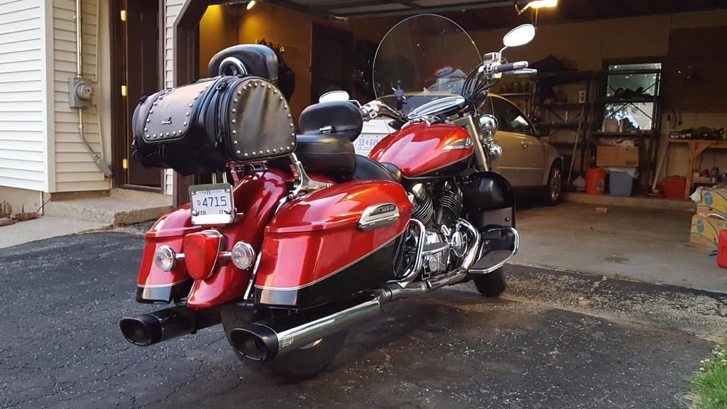

DarrinGT Posted August 15, 2016 Posted August 15, 2016 No doubt, Good call on that one,. Here is the deal, I installed the Monster Ovals on my 97 Royal when converting from 4 into4 exhaust to 4 into 2 exhaust. I also lowered the leather bags during the process so everything was custom made. Here is a pic of that: Then I got my 07 Royal and wanted to put the MO's on that bike before selling the 97, well I assumed that since any stock Harley touring muffler would fit with the brackets, than any aftermarket muffler for the Harley's would be a bolt on deal with the brackets as well. I went to swap them out and ran into the issue that you are running into, but I already bought the brackets. I took them to my buddys Machine Shop he cut them down drilled new holes. Should have just made new brackets. Pics of that: That said, The MO's have the mounting points moved back from the end more than the stock Harley Mufflers just because of how they are built. I can olny assume that when you buy new MO's for your harley they come with new brackets as well. So when I was getting the 97 ready to sell, I bought some HD mufflers from CL to replace the MO's, that is when I realized I had a problem. so I ended up installing the stock Venture Mufflers on the 97 instead. It was way easier to make a bracket for them and the guy that bought loved it because it was quiet. Plus they actually looked pretty nice on there,.. So yes, bottom line wen someone wants to put Vance and Hines Monster Ovals on their Royal or Venture, they will have to make their own Brackets. But they are worth the effort!

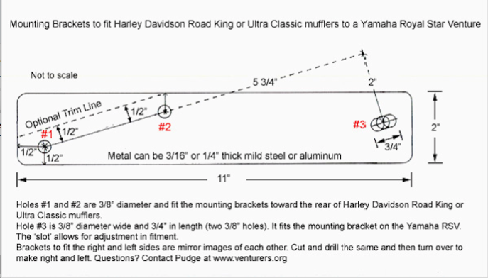

uechi kid Posted August 15, 2016 Author Posted August 15, 2016 (edited) I didn't have time this weekend to make revisions to the template but I'm sure that won't be a problem. I found plans for brackets that use 2" wide steel that look like they might be easier to make. See Attached. They are for the RK mufflers so I'll still need to make them to fit the MOs. Thanks for sharing the pics. Edited August 15, 2016 by uechi kid

uechi kid Posted February 19, 2018 Author Posted February 19, 2018 I didn't have time this weekend to make revisions to the template but I'm sure that won't be a problem. I found plans for brackets that use 2" wide steel that look like they might be easier to make. See Attached. They are for the RK mufflers so I'll still need to make them to fit the MOs. Thanks for sharing the pics. http://www.venturerider.org/forum/attachment.php?attachmentid=106920 This is what I finally did. I used a file folder and cut it 2" X 11" to use as a template. I slipped one of the mufflers on the header pipe and aligned it by eye. Then I took the blank file folder template and lined it up with the holes in the muffler and the bracket on the bike. I marked, on the blank file folder template where the holes need to be. Voila! Template to make my bracket.
