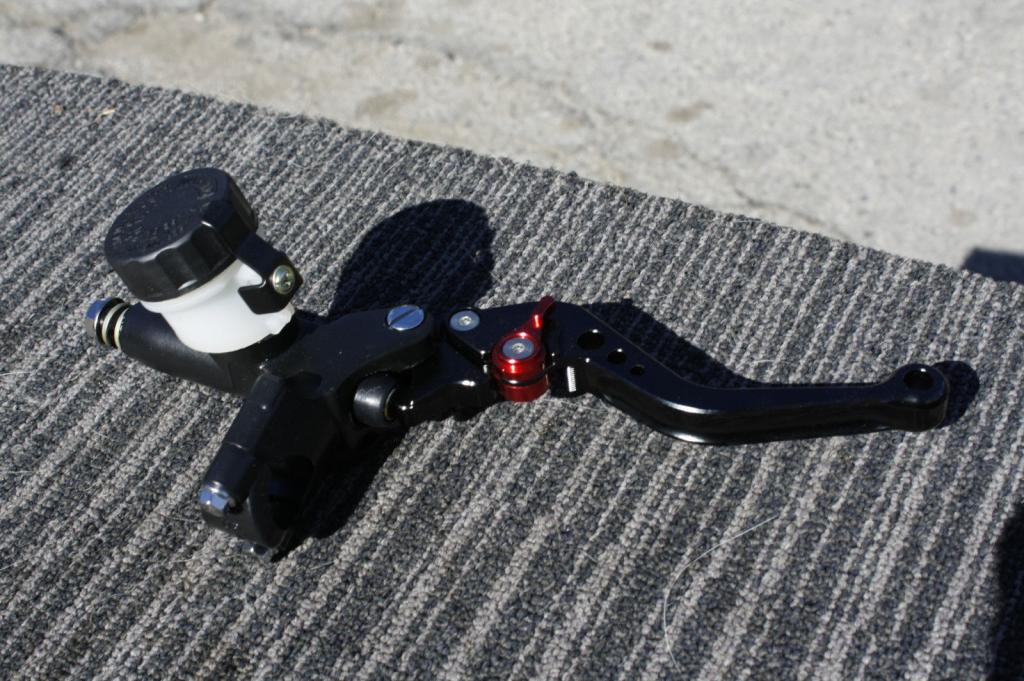

I am thinking of getting a NEW 16mm master and a set of R1 calipers. The new SS lines should be fine.
I will try the new 16mm master first.

A 16mm master is a lot less money than the R1/R6 calipers. Even if I do go with the R1/R6 calipers I still need a new master, I think the badly pitted master is a big part of my issue.

if you go to larger dia piston master cylinder you will have very fierce brakes with no feeling , smaller piston will give a lot more feel .
when doin the r1/6 conversion you can get a master from the road star line , 2 versions , 5/8 and 14mm which fit 1" bars

Here is a 17mm front master that I used on a Can Am Spyder project; $51

From your original post you did say you honed out the master, and it did have some pitting at the relaxed position.. ?? ... So what's happening is even tho you're pulling on the lever, the pressure isn't building up until the rubber cup moves a ways down the cylinder. Personally I'd replace the master/reserve with another. If the 14mm worked before, changing it to a bigger will actually help, but not for the reasons you'd think. It would replace the honed/pitted master you have now.... My 2¢
