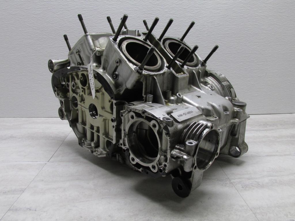

Prairiehammer Posted March 3, 2016 Posted March 3, 2016 The easiest and surest way to determine a 1200 from a 1300 engine is by looking at the engine number. BTW, care to submit your VIN? And build date?

Prairiehammer Posted March 9, 2016 Posted March 9, 2016 The easiest and surest way to determine a 1200 from a 1300 engine is by looking at the engine number. Engine number location:
