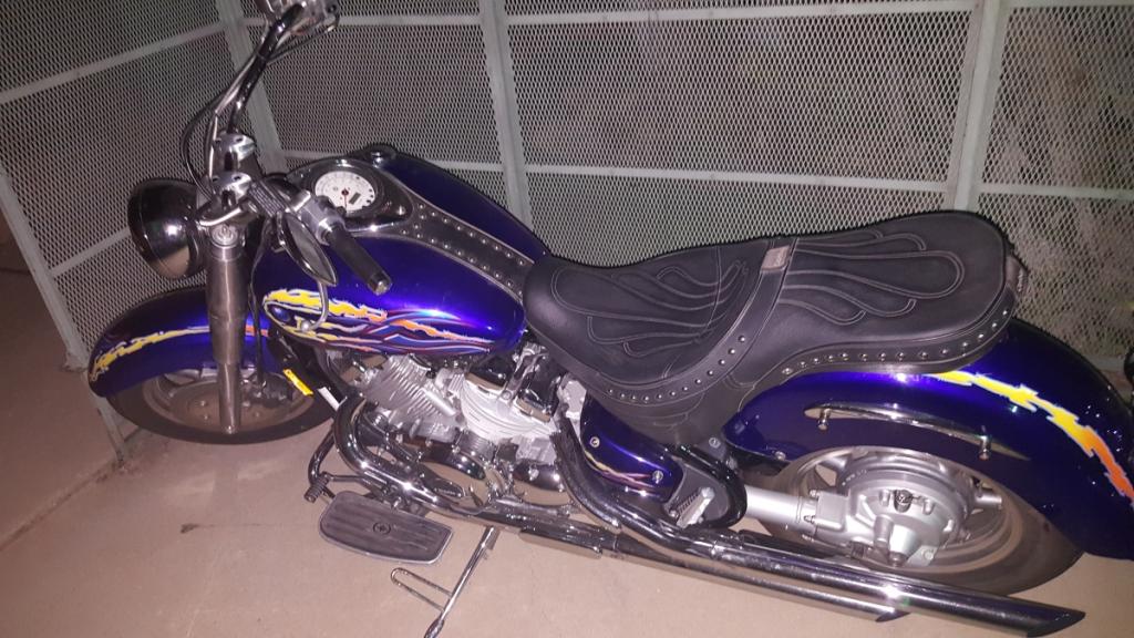

StarFan Posted January 25, 2016 Posted January 25, 2016 So if someone could answer a question, Did the stock Royal Star's 96-01 (RSTD,RSV & RSTC) come with 4 into 4 pipes, or did the previous owner of my bike do this to my bike? I need to do my pipes first cause i literally have no backpower on my bike right now as the previous owner changed the pipes on them and didn't get the bike rejetted. I am not sure the previous owner has messed with your pipes. The thing is, Yamaha went a little back and forward with the headerpipe setup through the years on the older Royal Stars. It is highly possible that your bike came originally with this setup. The mufflers on your bike do not look original to me. Don´t remember that slash cut on these bikes. I sincerely doubt that they are Yamaha mufflers. If the bike is lacking power I would look somewhere else than at the muffler/exhaust setup. One way to check if these mufflers are Yamaha is to have a close look at them all around. There should be a Yamaha stamp and some letters somewhere on the inner side towards the bike or the underside. At least I have seen that on all bikes that I have taken the original mufflers of off.
michaelclaw Posted January 25, 2016 Author Posted January 25, 2016 I am not sure the previous owner has messed with your pipes. The thing is, Yamaha went a little back and forward with the headerpipe setup through the years on the older Royal Stars. It is highly possible that your bike came originally with this setup. The mufflers on your bike do not look original to me. Don´t remember that slash cut on these bikes. I sincerely doubt that they are Yamaha mufflers. If the bike is lacking power I would look somewhere else than at the muffler/exhaust setup. One way to check if these mufflers are Yamaha is to have a close look at them all around. There should be a Yamaha stamp and some letters somewhere on the inner side towards the bike or the underside. At least I have seen that on all bikes that I have taken the original mufflers of off. Yeah i had looked before and didn't see any stamp on them, thats what my other friend had said about the mufflers. (They aren't oem) Unrelated: If i was to purchase this batwing this would it fit on my bike with some custom brackets or mounting system? eBay Link
ToyOdie Posted January 25, 2016 Posted January 25, 2016 (edited) Yeah i had looked before and didn't see any stamp on them, thats what my other friend had said about the mufflers. (They aren't oem) Unrelated: If i was to purchase this batwing this would it fit on my bike with some custom brackets or mounting system? eBay Link First of all nice bike. I have had a 96 RSTC and currently rida a 97 RSTC. The pipes on you bike are OEM. Both of mine had/have slash cut pipes. If I'm correct, the first bike with 4X2 was the 99 RSV. I can't remeber who, but I was told all 99-05 4X2 header pipes will fit our bikes. The support for the mufflers will need to be fabricated if you don't have the Yamaha hard bags and supports installed. I have been looking for the whole rear end from a Venture that I can swap. I would like to make mine a poor mans Venture. Besides it's more fun to build it yourself. Hear is a link for my fairing installation: http://www.venturerider.org/forum/showthread.php?96433-Faring-Installation This is another couple of good links for Moding an early 2nd gen RSTC http://www.venturerider.org/forum/showthread.php?56020-Time-to-start-Tearing-into-the-Bike&highlight=tearing+bike http://www.venturerider.org/forum/showthread.php?83141-Tearing-into-the-bike-part-Deux&highlight=DarrinGT Edited January 25, 2016 by ToyOdie
michaelclaw Posted January 25, 2016 Author Posted January 25, 2016 (edited) First of all nice bike. I have had a 96 RSTC and currently rida a 97 RSTC. The pipes on you bike are OEM. Both of mine had/have slash cut pipes. If I'm correct, the first bike with 4X2 was the 99 RSV. I can't remeber who, but I was told all 99-05 4X2 header pipes will fit our bikes. The support for the mufflers will need to be fabricated if you don't have the Yamaha hard bags and supports installed. I have been looking for the whole rear end from a Venture that I can swap. I would like to make mine a poor mans Venture. Besides it's more fun to build it yourself. Hear is a link for my fairing installation: http://www.venturerider.org/forum/showthread.php?96433-Faring-Installation This is another couple of good links for Moding an early 2nd gen RSTC http://www.venturerider.org/forum/showthread.php?56020-Time-to-start-Tearing-into-the-Bike&highlight=tearing+bike http://www.venturerider.org/forum/showthread.php?83141-Tearing-into-the-bike-part-Deux&highlight=DarrinGT Hey! I had looked at your topic before , but the only thing is i couldn't tell what kind of fairing you had purchased. The eBay link i had chosen looks like yours but for the fairing since it's not obviously going to mount on normally what kind would i need to chose? Can you link me one? Could you take a really close up of you mounted it so i could get an idea? Also how much did you end paying for the whole fairing project, i'm hoping it will be under one thousand but i'm still learning all of this haha *Edit* So i saw this fairing that mentioned "Stealth", this one seems like maybe the one you had purchased? link Edited January 26, 2016 by michaelclaw
michaelclaw Posted January 25, 2016 Author Posted January 25, 2016 First of all nice bike. I have had a 96 RSTC and currently rida a 97 RSTC. The pipes on you bike are OEM. Both of mine had/have slash cut pipes. If I'm correct, the first bike with 4X2 was the 99 RSV. I can't remeber who, but I was told all 99-05 4X2 header pipes will fit our bikes. The support for the mufflers will need to be fabricated if you don't have the Yamaha hard bags and supports installed. I have been looking for the whole rear end from a Venture that I can swap. I would like to make mine a poor mans Venture. Besides it's more fun to build it yourself. Hear is a link for my fairing installation: http://www.venturerider.org/forum/showthread.php?96433-Faring-Installation This is another couple of good links for Moding an early 2nd gen RSTC http://www.venturerider.org/forum/showthread.php?56020-Time-to-start-Tearing-into-the-Bike&highlight=tearing+bike http://www.venturerider.org/forum/showthread.php?83141-Tearing-into-the-bike-part-Deux&highlight=DarrinGT Hey! I had looked at your topic before , but the only thing is i couldn't tell what kind of fairing you had purchased. The eBay link i had chosen looks like yours but for the fairing since it's not obviously going to mount on normally what kind would i need to chose? Can you link me one? Could you take a really close up of you mounted it so i could get an idea? Also how much did you end paying for the whole fairing project, i'm hoping it will be under one thousand but i'm still learning all of this haha I was looking at this fairing, link, is that what yours was when u purchased it?

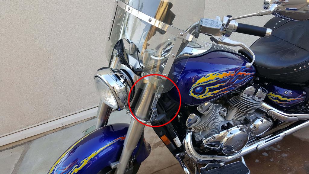

michaelclaw Posted January 26, 2016 Author Posted January 26, 2016 I was thinking i would mount the fairing on my windshield mount but i wanted to know how you guys have mounted your fairings on. [ATTACH=CONFIG]103185[/ATTACH]
ToyOdie Posted January 26, 2016 Posted January 26, 2016 Hey! I had looked at your topic before , but the only thing is i couldn't tell what kind of fairing you had purchased. The eBay link i had chosen looks like yours but for the fairing since it's not obviously going to mount on normally what kind would i need to chose? Can you link me one? Could you take a really close up of you mounted it so i could get an idea? Also how much did you end paying for the whole fairing project, i'm hoping it will be under one thousand but i'm still learning all of this haha *Edit* So i saw this fairing that mentioned "Stealth", this one seems like maybe the one you had purchased? link Here is a link to the fairing that I bought. Any of the fairings that have the word "Gelcoat" in the title are from the same vendor. http://www.ebay.com/itm/Yamaha-Roadstar-Motorcycle-Fairing-1600-1700-2-Speaker-Batwing-Gelcoat-/351286976004?vxp=mtr&hash=item51ca55de04 When I bought it there were more available and you could bid on them. I spent almost 2 months bidding until I got it for the price I wanted to pay. (Nobody wanted to bid on Thanksgiving Day ) I built my fairing for less than $250. That included the stereo, speakers, and gauges. If your budget is up to $1000, I would look at fairings that come pre assembled. http://www.recklessmotorcycles.com/royal_star.htm or http://hoppeindustries.com/store/index.php?cPath=21_33_49 As far as fitment for mine. All I had to do was put a little "S" bend in the mount brackets to make them 1/4 inch wider to fit the stock windshield mount. DarrinGT bought a fairing for a Roadstar and did the same thing to make it fit. His wasn't the same as mine. The other thing you need to do is get a set of Venture risers so the fairing will clear. The Venture risers kick back. I also added a 2" riser extention to bring the bars back for comfort. That made all the difference for me. I also had RickButler mod my seat. Money well spent!

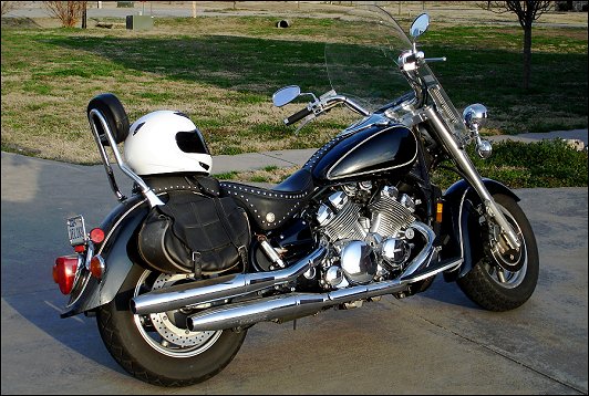

StarFan Posted January 26, 2016 Posted January 26, 2016 The pipes on you bike are OEM. Both of mine had/have slash cut pipes. If I'm correct, the first bike with 4X2 was the 99 RSV. I can't remeber who, but I was told all 99-05 4X2 header pipes will fit our bikes. Well Toyodie I think this is not quite correct. These Slash Cut Pipes ARE aftermarket or OEM from other bike brands.. Yamaha never made a Slash Cut for the Royal Stars. Here below you can see a picture of the original 4 into 4 pipes on a 1999 Tour De Lux. This is the same setup that was used from 1996 and onward. In 1996 there was only 4 into 4 available. In 1997 the 4 into 2 was available at certain models. Both my 1998 Tour Classic II´s were original and untampered with when I bought them and both had the 4 into 2 setup. Original Yamaha 4 into 4 exhaust Yamaha Royal Star 1999 http://i1281.photobucket.com/albums/a501/jonaslill/pc-1999-royal-star_zps0pq7ikcc.jpg
ToyOdie Posted January 26, 2016 Posted January 26, 2016 Well Toyodie I think this is not quite correct. These Slash Cut Pipes ARE aftermarket or OEM from other bike brands.. Yamaha never made a Slash Cut for the Royal Stars. Here below you can see a picture of the original 4 into 4 pipes on a 1999 Tour De Lux. This is the same setup that was used from 1996 and onward. In 1996 there was only 4 into 4 available. In 1997 the 4 into 2 was available at certain models. Both my 1998 Tour Classic II´s were original and untampered with when I bought them and both had the 4 into 2 setup. Original Yamaha 4 into 4 exhaust Yamaha Royal Star 1999 http://i1281.photobucket.com/albums/a501/jonaslill/pc-1999-royal-star_zps0pq7ikcc.jpg OK, you got me curious. I went out and pulled One of my pipes and found no Yamaha part numbers. It just seems strange that both of my bikes had the same pipes on them. I did a search on Royal Star Tour classics and found several bikes with the same pipes that appear to be stock. All the bikes that I did find had the two-tone paint scheme. Maybe this was an option that the dealer could install.
