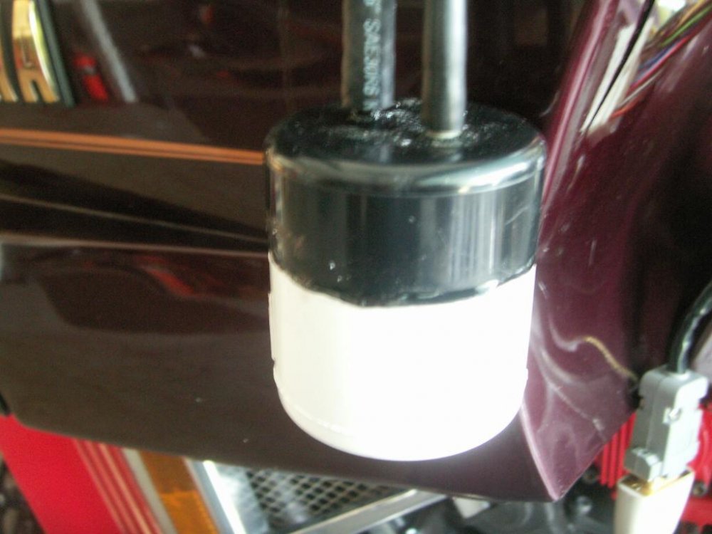

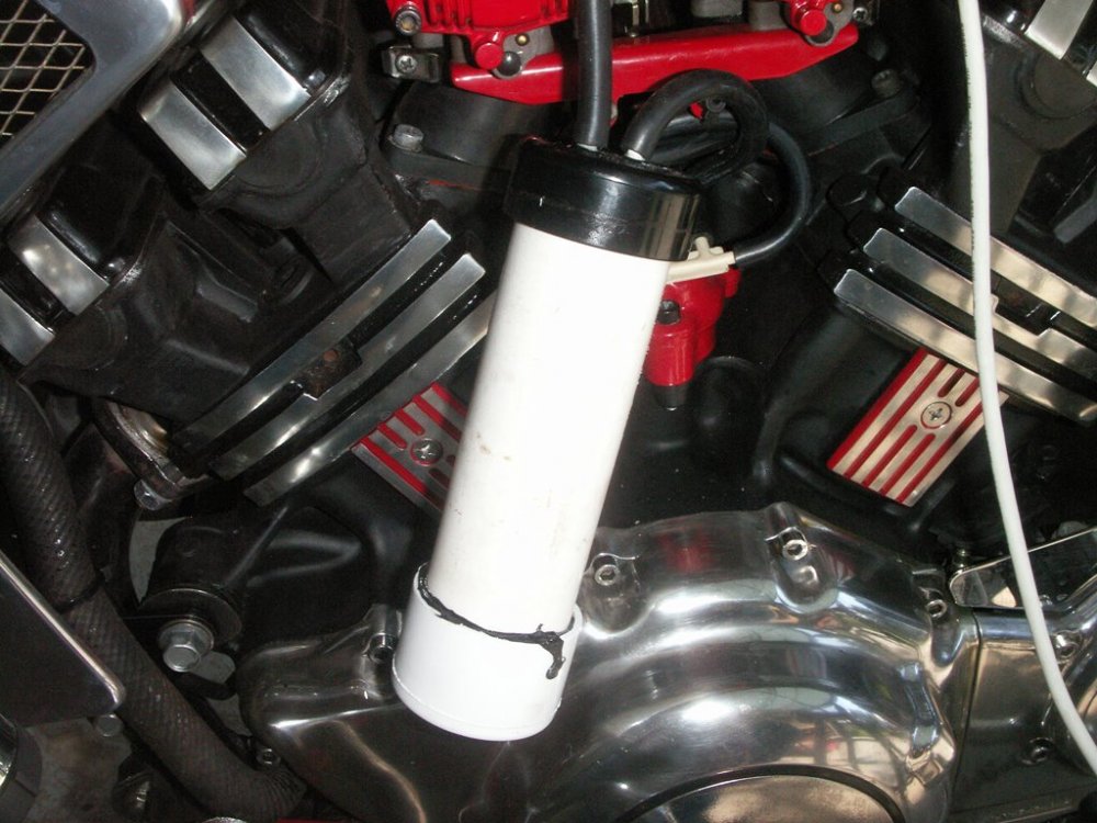

lonestarmedic Posted September 8, 2015 Author Share #65 Posted September 8, 2015 I built a small vacuum reservoir for the MAP sensor. Sent all 4 ports to a union. Then put in the restrictor. At that point I attached the Dingy-Can and then on to the MAP sensor. Sucsess!! The voltage readings are stabilized at only a maximum 3% variance. I may need to adjust the voltage values a bit yet. I like my 100% as it is. Running 4.7 volts. The reading taken with the engine off and no vacuum. My lower voltage is currently ar 3.2 volts. It may need a bit of lowering yet. Goingto figure out how to tie down the reservoir then go ride. Ended up with reservoir up on top of coil bracket next to MAP sensor. Remember, did coil on plug conversion so bracket was empty. http://images.tapatalk-cdn.com/15/09/07/c02d8e09b377381f8c06b2a303786940.jpg Link to comment Share on other sites More sharing options...

dingy Posted September 9, 2015 Share #71 Posted September 9, 2015 I'm not sure I get it. does dingy's ignetech and MAP sensor as delivered running off the #2 vacuum port work or is there a tach issue that requires the dwell to be set at auto, and an advance curve issue that requires the idle advance to be set to 7 degrees and tweeks elsewhere, and a then the 4 into 1 vacuum can and map voltages to be adjusted?? I thought this was a mature system to replace the TCI.. I do not believe I have ever said the Ignitech TCI was perfect as I deliver it. I even have included PDF files on the CD as how to tweak it, specifically there is one on there about how to reset the MAP sensor voltages, I wouldn't have done that if I thought it was perfect. I often see post on here that people think they have a TCI issue and I don't immediately try to sell them one. I offer suggestions that I know could be causing problems that are sometimes misdiagnosed as a TCI issue. Not saying I don't supply a link to my classified add though, not real stupid. TVking was 1st I am aware of that made an effort to promote Ignitech here. http://www.venturerider.org/forum/showthread.php?40414-Aftermarket-TCI-available!&highlight=ignitech+thread Every bike is somewhat different, coupled with rider differences and what each rider thinks is important is what makes this unit a much more versatile option than a stock decades old TCI. I was far from the first to explore this unit. I was the one that invested in making them available to riders here and on VMax site. At first I relied on 'copays' from people wanting to invest in one, but for the last few years have been able to front the funds required to purchase these in quantities that made sense to me to do. I am very active in this and the original Ignitech thread on sharing what I have learned from people that have one, at times even people that didn't get unit from me. Sometimes I see post about ideas that I don't believe in, but I don't post negatively about an idea unless I have past experience that says it won't do what is suggested. I don't know or understand everything about this unit. I do believe I have more hands on experience & understanding with it as it relates to Ventures & VMax's than the people at Ignitech though. They have not upgraded their curve on it since they 1st added it to the list of bikes supported. About 25% of the harnesses I get from them are wired incorrectly, which I have told them about and they insist it will run the way they deliver it irregardless of differences in harness. The canister idea was first brought up by me in Feb. 2012, certainly not a new idea. Post #262 in thread linked above. Gary Link to comment Share on other sites More sharing options...
dingy Posted September 9, 2015 Share #72 Posted September 9, 2015 I built a small vacuum reservoir for the MAP sensor. Sent all 4 ports to a union. Then put in the restrictor. At that point I attached the Dingy-Can and then on to the MAP sensor. Sucsess!! The voltage readings are stabilized at only a maximum 3% variance. I may need to adjust the voltage values a bit yet. I like my 100% as it is. Running 4.7 volts. The reading taken with the engine off and no vacuum. My lower voltage is currently ar 3.2 volts. It may need a bit of lowering yet. Goingto figure out how to tie down the reservoir then go ride. Ended up with reservoir up on top of coil bracket next to MAP sensor. Remember, did coil on plug conversion so bracket was empty. http://images.tapatalk-cdn.com/15/09/07/c02d8e09b377381f8c06b2a303786940.jpg I initially started out with a longer canister, through several tries, I settled on as short of a canister as I could get with 1 1/4" PVC. What I saw from TP graph was that the longer canister induced a lag in response to throttle opening. This is due to larger canister takes longer to reach an equilibrium in relation to PSI changes. The short can provided a helpful buffer, while not inducing to much lag. Just my experience. Picture of first try and last one attached. Gary Link to comment Share on other sites More sharing options...
lonestarmedic Posted September 9, 2015 Author Share #73 Posted September 9, 2015 As you can see, mine is a 1.25" coupler and a pair of plugs inside it. Probably a bit smaller volume even than your capped pipe. I do not really see a response lag. And tonight's butt-o-meter indicates good to go. The bike now has a very different personality! Link to comment Share on other sites More sharing options...
