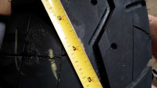

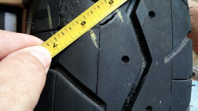

djh3 Posted July 7, 2015 Posted July 7, 2015 Not that I have done that, but I can assure you, you are not the first. I have to read the "how to change the rear wheel" thread about every time I have mine off to ensure I get assembly correct. And that is one thing mentioned is correct spacer placement. glad your up and running. Last year after about 3 weeks with a brand new tire I had a flat coming home one day. I plugged it and was going to take it apart and patch from inside. when I got it off I decided the way the foreign object cut it I would just replace the tire. 1500 miles on the brad new one ouch.
