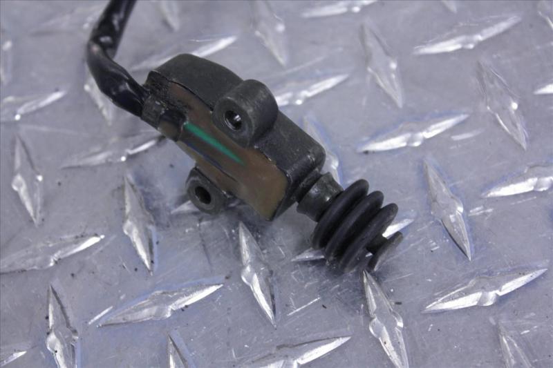

Donvito Posted March 17, 2015 Posted March 17, 2015 I can't find any info on cleaning or maintaining the sidestand switch. Since new replacements aren't available, except one on ebay for $100, I was wondering if there is a way to prolong it's life. Any advice?

Donvito Posted March 18, 2015 Author Posted March 18, 2015 Thanks for the suggestions but I guess I wasn't clear. My switch is still working so I'm not looking for a used one at this point. I was wondering if there is anything that should be done to my switch to maintain it. I haven't seen any instructions on disassembling and cleaning that switch like I have for the other switches.
Venturous Randy Posted March 18, 2015 Posted March 18, 2015 Using contact cleaner spray with one of the little tubes, I will stick the tube up under the rubber dust cover and spray liberally. I will also push the plunger in and let it pop out. This has worked for me. Randy
videoarizona Posted March 18, 2015 Posted March 18, 2015 Judging from the looks of the unit, it seems Randy has the only cleaning thought. It looks like the back side is sealed...??
Prairiehammer Posted March 18, 2015 Posted March 18, 2015 Thanks for the suggestions but I guess I wasn't clear. My switch is still working so I'm not looking for a used one at this point. I was wondering if there is anything that should be done to my switch to maintain it. I haven't seen any instructions on disassembling and cleaning that switch like I have for the other switches. Using contact cleaner spray with one of the little tubes, I will stick the tube up under the rubber dust cover and spray liberally. I will also push the plunger in and let it pop out. This has worked for me. Randy In addition to Randy's advice for cleaning with contact cleaner, fill the rubber boot with silicone grease to exclude moisture.
Donvito Posted March 19, 2015 Author Posted March 19, 2015 (edited) In addition to Randy's advice for cleaning with contact cleaner, fill the rubber boot with silicone grease to exclude moisture. Thanks for the advice but can you be a little more specific as to which type of silicone grease you use and how do you fill the rubber boot with it. Thanks. Edited March 19, 2015 by Donvito
Prairiehammer Posted March 20, 2015 Posted March 20, 2015 Thanks for the advice but can you be a little more specific as to which type of silicone grease you use and how do you fill the rubber boot with it. Thanks. Silicone grease is available at your local home center or hardware store, in the plumbing section, where it is used as a faucet lubricant. Dielectric grease is also a silicone grease, but sold in much smaller (and expensive) packages. The rubber boot is slipped over a barbed shoulder at the body of the side stand switch. Peel the rubber boot off the shoulder and apply the grease into the now open end of the boot. Replace the boot onto the shoulder after inserting the grease.
