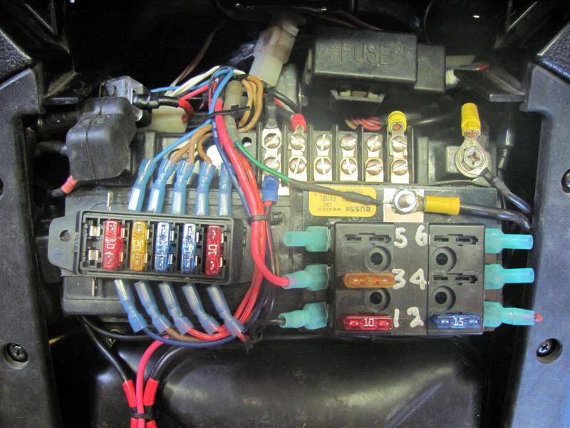

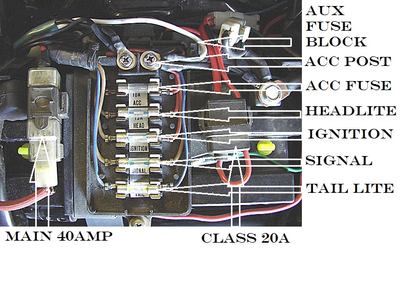

Prairiehammer Posted February 19, 2015 Posted February 19, 2015 Thanks for all the attention, and the big welcome. I have been a Yamaha fan since I got my first 550 Maxim. I've always liked the look of the Venture, but never found one in good enough condition to even consider until now. This one my mechanic found for me and worked an amazing deal for it. Literally an "offer I couldn't refuse" type deal. Boy am I glad he did. I noticed that the original fuse box appears to be in really good condition, but there is a second fuse holder installed close to the steering neck. I say installed, but it's more like a floater in that it's not mounted to anything, just hanging out up near the fairing on the right side (driver's perspective, that is.) I'll tear into it in a bit. I just got back from running some errands and thought I would see if anyone had any advice for me. Thanks again and I'll keep you folks posted. Annotated pics of the primary fuse block with glass fuses and another pic of my revamped primary fuse block along with the second OEM fuse holder as well as the auxiliary fuse block I added.
