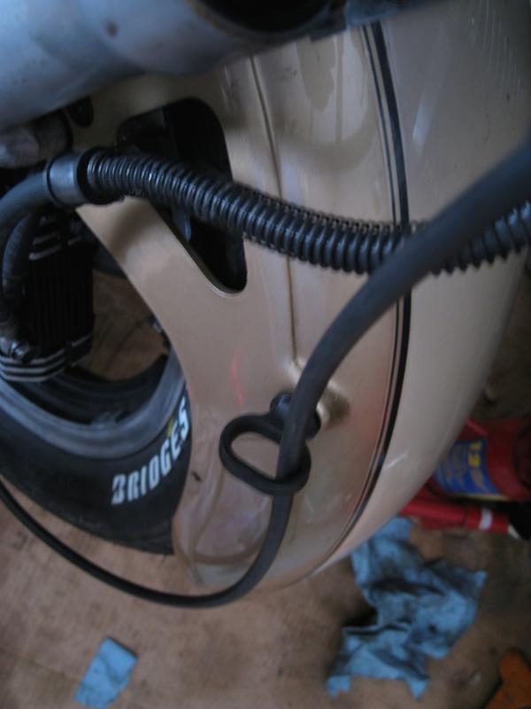

Peder_y2k Posted June 15, 2013 Share #7 Posted June 15, 2013 'Courding to the manual, the cable only passes through the rubber guide on the front fender. -Pete, in Tacoma WA USA '83,88 Link to comment Share on other sites More sharing options...

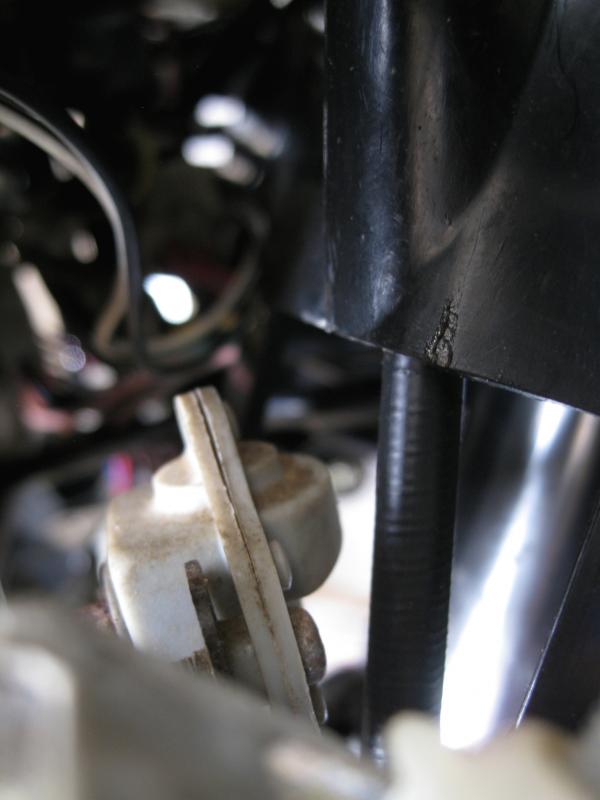

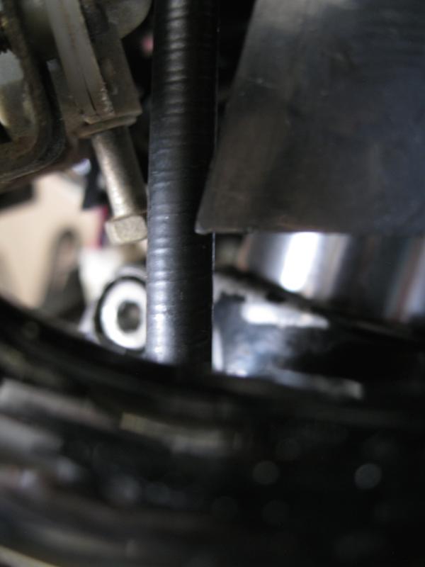

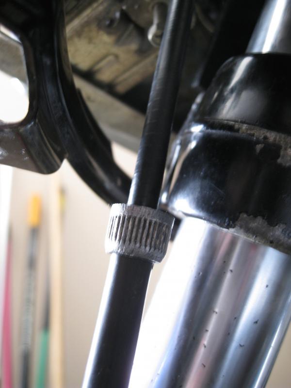

flyday58 Posted January 8, 2015 Share #9 Posted January 8, 2015 Resurrection time! I've had my speedo cable off and on a couple times working on the instrument cluster/dash/gauges with no probs. But I'm finishing up rebuilding the forks, and now the same routing is catching on the lower pinch bolt blivet when I turn the forks to the left. Never did this before that I noticed. Bike is still off the ground on jacks and catches when near full left turn. There's no bracket, clip, or hole to run it through. Looking at the indent for the cable in the plastic cowling inner panel below the cluster, if the cable sits properly in that indent then it has to run where it is. Only now it catches. I may have to use a zip tie loosely fastened to hold the cable out of the way. Just bugs me that it never got in the way before. I'll take some pics later, but it's 25 degrees in the garage. In southern Miss that means schools are closed, the interstate is sanded (no salt), all flights are grounded, and the trash don't run. Link to comment Share on other sites More sharing options...

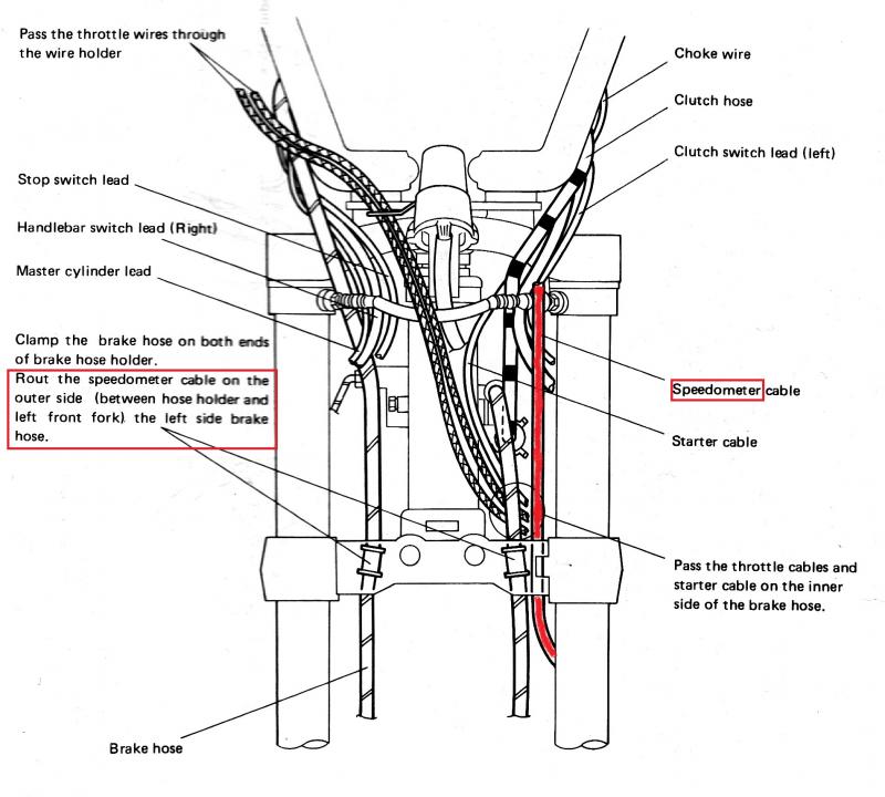

Prairiehammer Posted January 8, 2015 Share #10 Posted January 8, 2015 Below is the factory specified speedometer cable routing; additionally, make sure the speedometer cable is threaded through the grommet on the fender. Link to comment Share on other sites More sharing options...
Marcarl Posted January 8, 2015 Share #11 Posted January 8, 2015 Resurrection time! I've had my speedo cable off and on a couple times working on the instrument cluster/dash/gauges with no probs. But I'm finishing up rebuilding the forks, and now the same routing is catching on the lower pinch bolt blivet when I turn the forks to the left. Never did this before that I noticed. Bike is still off the ground on jacks and catches when near full left turn. There's no bracket, clip, or hole to run it through. Looking at the indent for the cable in the plastic cowling inner panel below the cluster, if the cable sits properly in that indent then it has to run where it is. Only now it catches. I may have to use a zip tie loosely fastened to hold the cable out of the way. Just bugs me that it never got in the way before. I'll take some pics later, but it's 25 degrees in the garage. In southern Miss that means schools are closed, the interstate is sanded (no salt), all flights are grounded, and the trash don't run. If you look at the bottom half of the triple tree, there is a plastic piece on the front with pass through holes. It's a two piece with 2 or 1 screws I think. It routes through there. So I was a minute late,,,, oh well early bird gets the worm!! Link to comment Share on other sites More sharing options...
flyday58 Posted January 8, 2015 Share #12 Posted January 8, 2015 Link to comment Share on other sites More sharing options...
Prairiehammer Posted January 8, 2015 Share #13 Posted January 8, 2015 You have the speedo cable FORWARD of the lower triple tree. See on my diagram that the speedo cable goes REARWARD of the lower triple tree. Link to comment Share on other sites More sharing options...
flyday58 Posted January 8, 2015 Share #14 Posted January 8, 2015 Thanks to both. Had rerouted behind the lower triple tree and was coming in to post. Thanks Kevin and Marcarl. Link to comment Share on other sites More sharing options...
