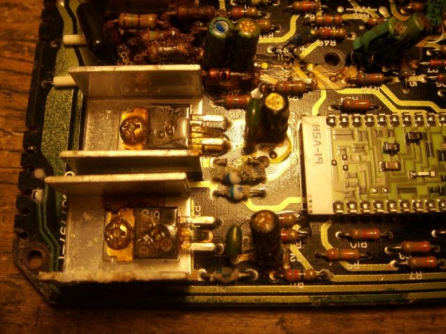

mbrood Posted May 2, 2013 #4 Posted May 2, 2013 The two holes in the case let condensation in so many find some corrosion and junk that needs cleaned up. The output power transistors are still available, they are protected by reverse spike damping diodes... the early ones were glass (blue and gray) and had a nasty habit of going bad after only a bit over 20 years... there are 8 and should be replaced by ones out of the 1N4001 series. If the diode goes bad, the reverse voltage from the ignition coil typically takes out the power transistor but it too can be replaced if it didn't short to B+ and take out the micro-controller feeding it.... if it did you are looking at a total replace... If you do replace anything, please insure that you get some fresh conformal coating over the pads to keep corrosion at bay. You can see the glass diodes here, two for each of the four power transistors on the right... http://www.bergall.org/temp/venture/tci/tci2.jpg
ddoggma Posted May 3, 2013 #5 Posted May 3, 2013 IS it just me? Or does that look like one, bad cap, nasty ass circuit board. I sure hope mine don't look like that...lol, But I know is does:Avatars_Gee_George: I had water shooting up thru the air vents, one day. That didn't help, So far bike runs well.

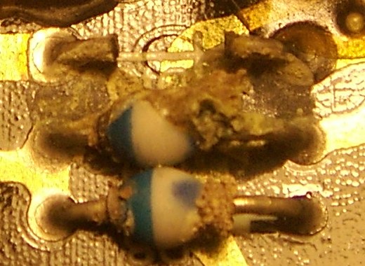

dingy Posted May 3, 2013 #6 Posted May 3, 2013 (edited) ddoggma said: IS it just me? Or does that look like one, bad cap, nasty ass circuit board. I sure hope mine don't look like that...lol, But I know is does:Avatars_Gee_George: I had water shooting up thru the air vents, one day. That didn't help, So far bike runs well. Actually that one looks good. Few closeup pictures of corroded diodes attached. You can use any 1N4000 series diode, 1N4000, 1N4001, ... 1N4007. Higher number indicates reverse voltage rating. All will work with 12V circuit. Gary Edited May 30, 2016 by Freebird
Venturous Randy Posted May 3, 2013 #7 Posted May 3, 2013 ddoggma said: IS it just me? Or does that look like one, bad cap, nasty ass circuit board. I sure hope mine don't look like that...lol, But I know is does:Avatars_Gee_George: I had water shooting up thru the air vents, one day. That didn't help, So far bike runs well. That is probably one of the better looking TCI's that I have seen. Most look much worse than this, even good working ones. RandyA
icebrrg3rd Posted May 3, 2013 #8 Posted May 3, 2013 So are the blue & grey thingys (circled in red) what are replaced with the 1N4000 series diodes? So how does my circuit board look? -Andrew
Flyinfool Posted May 3, 2013 #9 Posted May 3, 2013 icebrrg3rd said: So are the blue & grey thingys (circled in red) what are replaced with the 1N4000 series diodes? So how does my circuit board look? -Andrew YES Your board looks very clean. My board looked like that when I checked also. I replaced them anyhow since if any one of the 8 fails, the TCI is toast. AND they are 20 some years old and known to die. Save the pics to be sure that you put the new ones in the right way. The new diodes will most likely be a black cylindrical body with a silver band at one end, the silver band goes on the same side as the blue end of the old ones.
