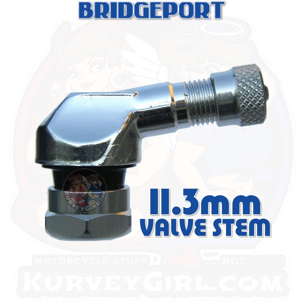

bugfish69 Posted July 2, 2011 #11 Posted July 2, 2011 On my first tire change with the venture, I ordered a set of 83 degree aluminum valve stems to make checking and filling easier. The valve stems were 11.3 mm which I was assured was a yamaha standard. Well the front fit great. I love it and it is still doing great. The rear however would not fit as the hole in the rim was too small. I am now two tire changes down the road and I believe I have found a 90 degree stem from K&L for the rear that will work. When I put the new tires on next week I will know for sure. http://www.kurveygirl.com/valve/AL%20Valve%20-%2011,3%20-%20Silver%20-%20Side%20View.jpg
Condor Posted July 2, 2011 #12 Posted July 2, 2011 Followed the link and it produced a pic. Here's one that will take you to all the info. Nice find.... http://kurveygirl.com/shop/product_info.php?cPath=27&products_id=144
