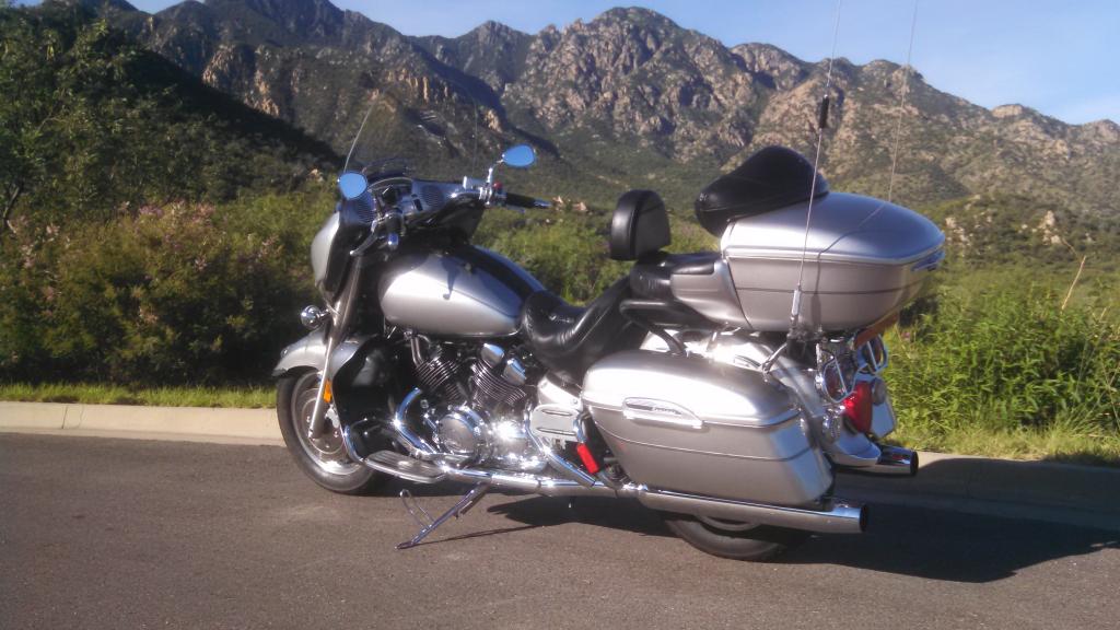

Beach Bum Posted September 26, 2015 #32 Posted September 26, 2015 videoarizona said: [ATTACH=CONFIG]101814[/ATTACH] Gratuitous scenic bike pic.FIFY
