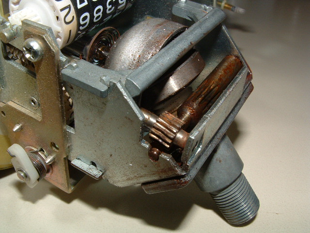

GeorgeS Posted August 28, 2007 Posted August 28, 2007 Close ups of the Speedo Red pen shows where you need to apply some light lubricant
