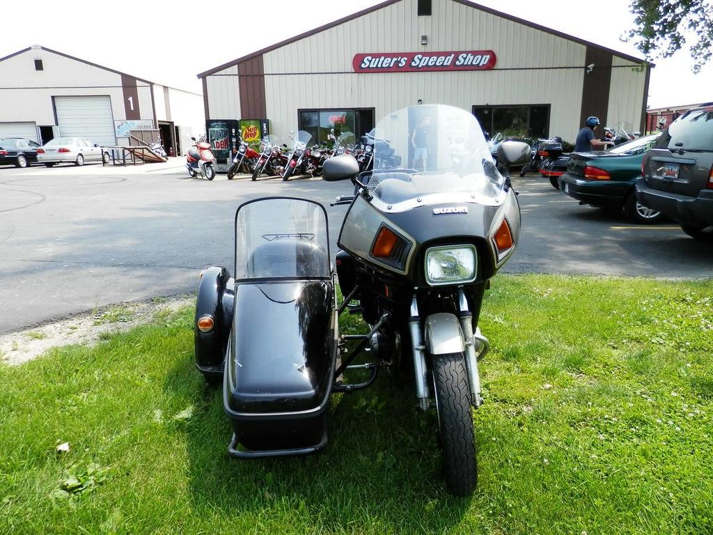

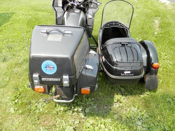

I have found a couple in my area & I hope you folks can help. How do I identify the model and year on a Velorex? Is there an ID plate on the car and where would it be located?
The first one is just the car & supposed to be a 700 model from 2005. I have a 2000 Venture – do you need "bike specific" attachments? Are they available for older cars? How much would they cost? (ballpark) Would this sidecar be a good match for my bike? Also – the brake is not working and he said there is no cable – are parts available to fix that? He’s asking $2800 – is that a decent price? I have included a picture if that might help. What do I look for so I don't get screwed? And what price could I buy it and break even if I had to sell it? He has the convertible top, too.
The second one is mounted on a 1984 Suzuki GS1100. The seller knows nothing about the car – not age, model, etc and there are very few pics of the car. I attached a pic of that rig – can you tell what year or model the car is? He's asking $4K for the rig, the bike has about 35K miles on it & value is about $1800 form the bike alone (Kelley). My thought was to buy this one as a "trainer" and see if I can learn to drive it. And if I even like it before I throw a bunch of money into getting a sidecar on my bike. Then, if I don't kill myself in the process - I could re-sell the 'Zuki and put the car on my Venture.
Alternate plan -- If I bought BOTH at a good price - I could fix the brake and get the car all gussied up while I learned to drive a sidecar rig w/ the 1100. If I like it - attach the car to the Venture, then sell the '84 Suzuki as a complete rig. And if I don't like the sidecar thing - sell them both.
Thoughts?

i dont know what new prices are for velorex sidecars in USA , but in the Uk it would be around 2500 gbp, this includes the 5 point fitting kit. except for triumph bonnie they do not make a bike specific kit , but are adjustable to suit any bike. you may need to fabricate some standoffs , eg where you need to make room around controls etc
the way to find out if its an old model is to measure the wheel spindle , also check that the frame has strengthening plates .
old models , designed for the jawa bikes have a 15mm axle new velorex models have 20mm axles

as for the prices , the suzuki outfit the sidecar is about 600 usd less than a new sidecar. it looks quite new and if it is set up properly, could be used for learning how to handle an outfit. you can always transfer to your rsv later as the fittings are adjustable.
Good thought - take the hack off the suzuki & put it on the Venture.
