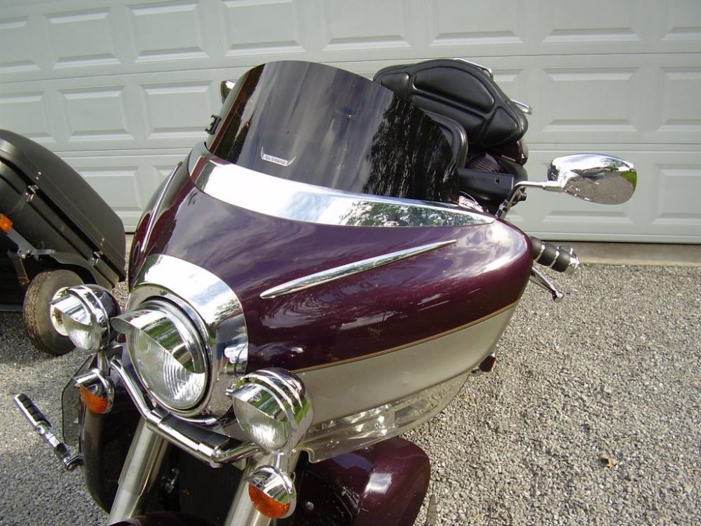

Finally got around to removing the antennas today. With the shorty windshield on now I'm kinda digging the new look.
