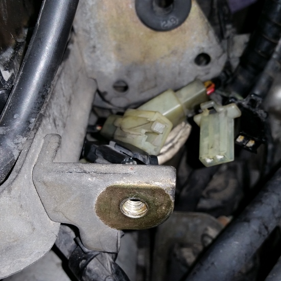

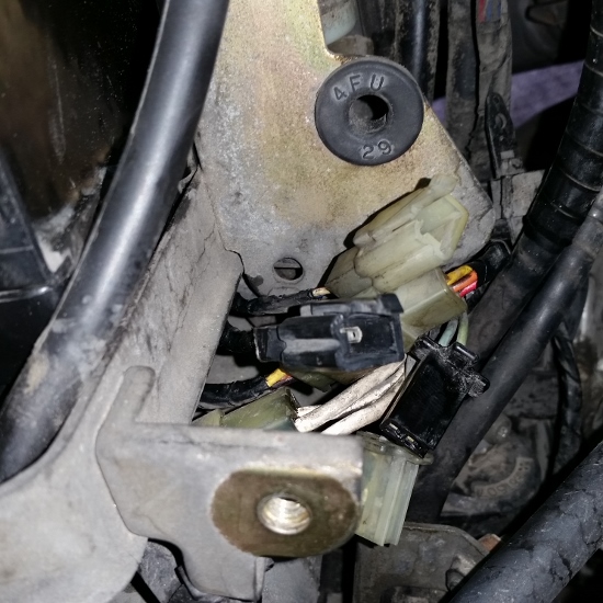

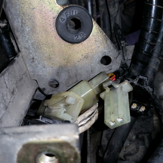

Ok I think these are the connectors. If they are the black one has no reading anymore. The white one is in upper spec. Any one confirm I'm correct? And this is a picture of bottom of coils wires on correct? I hope I'm correct but you never know till you ask. Hands shake so bad had a rough time with pictures. I want to thank you @dingy for the good wiring info the Clymers manual don't show ohms and connector colors that I could find -
