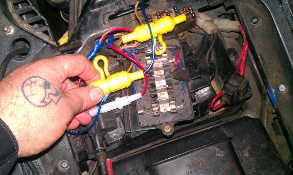

Finally found the issue!!!. It was the glass fuses. The signal fuse had broken loose inside. Still looked intact, and even had continuity through my meter, but wouldn't flow the juice. Replaced everything with ATC fuses and all is good. Now the issue is with the CLASS. It shows an E4 error, but it only lights up when switch is in acc.When ignition is on, it stays blank. -

Update: Still cant find any obvious issue. Going to change out the fuse holders with ATC type, hoping maybe the glass fuses are crap. Also, forgot to mention that the bike never had power to the CLASS. I have no idea if that has anything to do with the situation. -

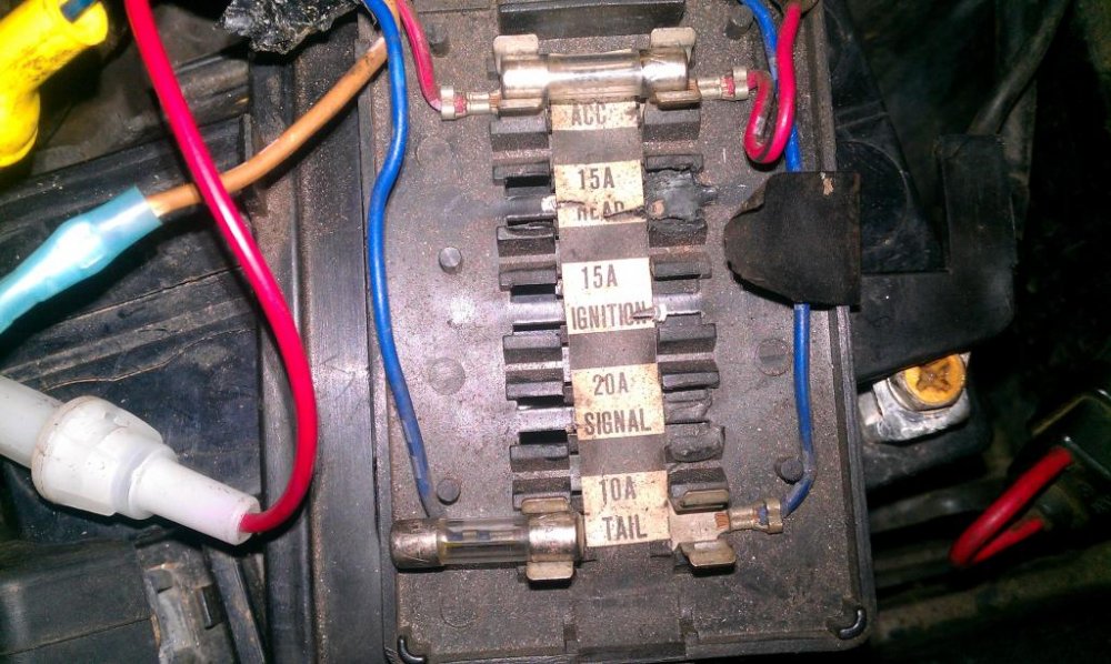

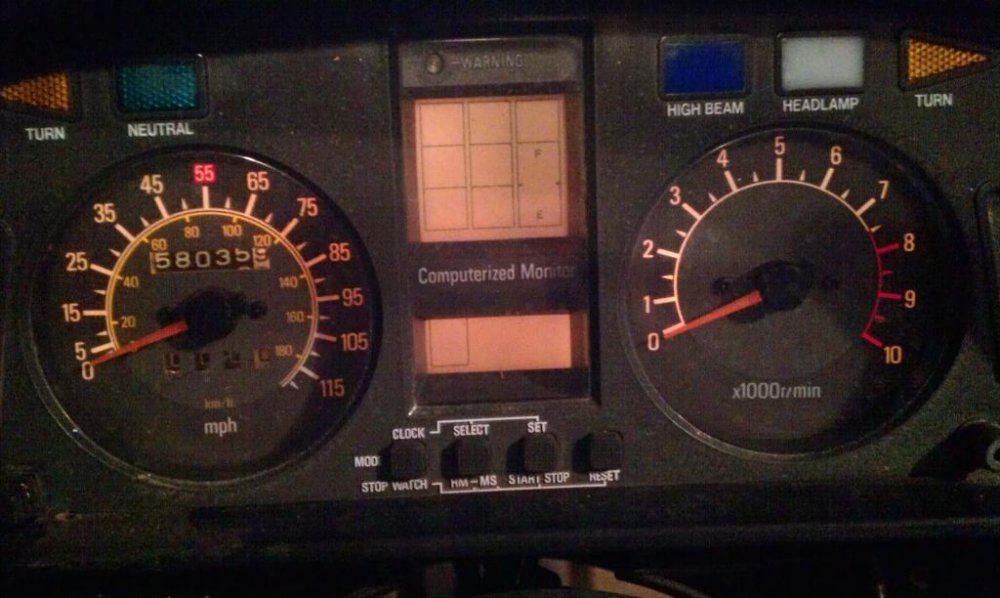

The first pic shows the inline fuses the second shows the fuse block and whats left wired in. the third shows the display. No neutral light, fuel gauge etc. What send the info to the display? -

Ok. Checked all fuses. All good. Checked as much wiring I could get to, nothing obvious. I've always been less than proficient with electronics, so that may be part of my problem. Also, the tail light wire leaving the fuse goes to ground, but the fuse didn't blow, but the wire and fuse holder got hot. I hope this project does not go like the other one. Pissed me off because the bike ran good on the way home. I figured I would change the plugs and be golden. -

Thanks for the input. I put an inline fuse for the ignition, headlight and turn signals. The metal prongs started breaking, so thats what started this whole process. Also, when you hit the starter button, the lights go out. I'll try to post up some pics later. -
Howdy folks. I was an active member here a couple of years ago, while working on a 83 with carb issues and whatnot. Got disgusted with that and scrapped the whole project. Now I just bought an 87 venture royal that ran great when I rode it home, so i changed the plugs and it started right up and ran even better. Then I replaced the fuses in the fuse holder with inline fuses because the prongs were broke on a few, now no display at all. It lights up, but no neutral light or anything and also won't start the bike. Any ideas on what happened after the fuse change?
