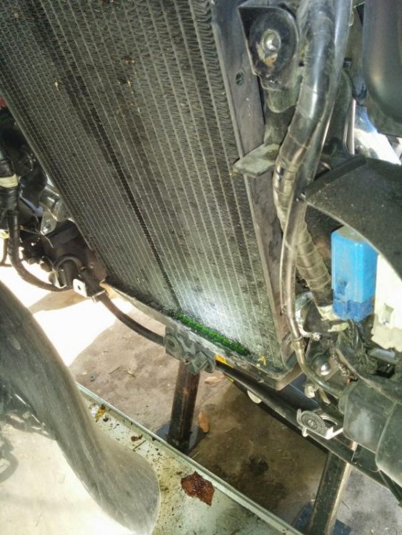

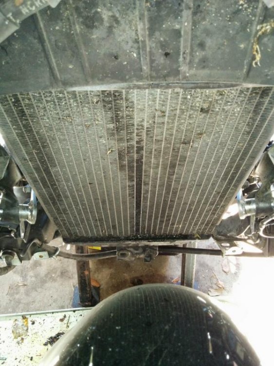

Update of a sorts. I got the radiator off and examined it. There didn't look to be any leak from the top pin (photo). There didn't look to be any leak at all. I tested the fan, and it works. I followed the steps for removing the thermostat but couldn't figure out how to get it out. Its a 3-D puzzle, and I am usually very good at that, but I couldn't get it out. So reversed myself and put the bike back together. Now that I have a better idea of where to look, I wanted to run it and see where it leaks. But now I have a leak out of the heat pipe 2. (photo) Reading parts lists, I note that there should be an o-ring, but I didn't see one. It is part 93210-18417-00 in the parts fiche, and is priced variously from $1.62 to $9.50. Surely it is just an o-ring. Anyone know the size? I thought I saw it listed here, but can't find it in searches. Edit: Does fluid leaking from the heat pipe indicate the water pump is working?

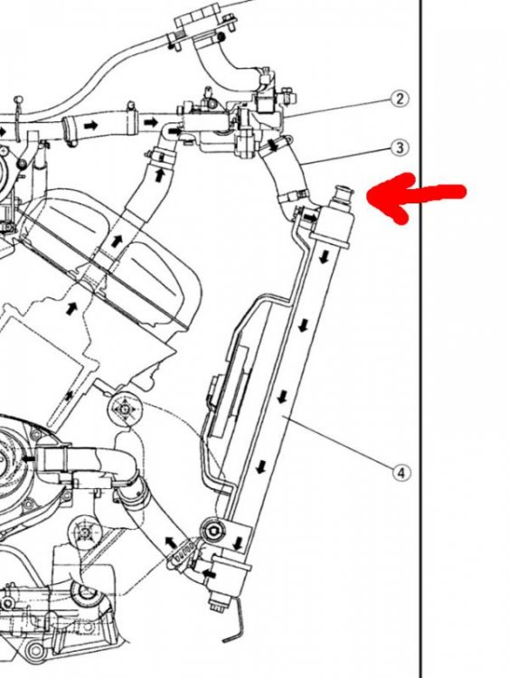

How do I get the top pin out of that red arrow'd bracket? It has a rubber bushing, but the mushroom top doesn't want to slip out?
Similar, I'd say. I'm attaching the manual's radiator disassembly instructions in case those could help you. Dave RSTD Radiator.pdf
Interesting! Does it look the same as my photo? I'm heading out in a moment to start taking the bike apart and investigate.
It requires the engine to be hot. The pressure tester is a good idea, though. That area is so hard to see in. I have seen green fluid higher up than the red arrow... condensation? Not sure how to get to the hoses, but I feel like coolant is dribbling down and collecting on the red arrow. I have felt the engine get really hot, which makes me wonder if the thermostat isn't working. Again, the part is hard to get to. Thanks for the ideas!

Along with a mysterious oil drip, my 2006 RSTD now features a coolant leak. I doubt it is the radiator, but that's where the leak manifests. There looks like a in front trickle, and I've seen fluid on that stem thing on the top. The trickle seems to come from the stem thing. (See photos) I've looked for visible wetness up top, but can't see any from the sides. I do see "steam" coming from low down... could that condense up top? Before I tear into that front end mess, does this ring a bell with someone? Dave
