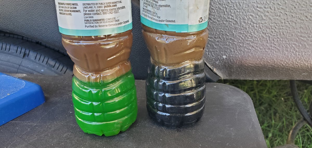

Just checked coolant overflow on my 2011 Venture/Hannigan (90,000 miles, bought at 80,000 in 9/24); found huge oil in it. (See pic.) In forumsearches I found primary causes seem to be water pump shaft seals and Twinkie o-rings. Planning to repair both locations; parts for water pump seals and shaft are enroute. Can't find proper part name for Twinkie, or part numbers, or kits. Planning to r&r water pump shaft and seals and o-rings and gaskets in Twinkie, then flush well with Dawn and refill. I have noticed no trace of coolant in oil or sweet smell/white smoke in exhaust. Can anyone enlighten me with info on twinkie seals, gaskets, etc? Thank you in advance!!
Oil in my coolant also; discovered 2 days ago. A lot of sludge. Ordered pump rebuild kit and seals but can find no info on twinkie including proper part name. Need seals and o-rings for it; can anyone help with name, part numbers, etc? 2011 Venture, 91,000 miles.
