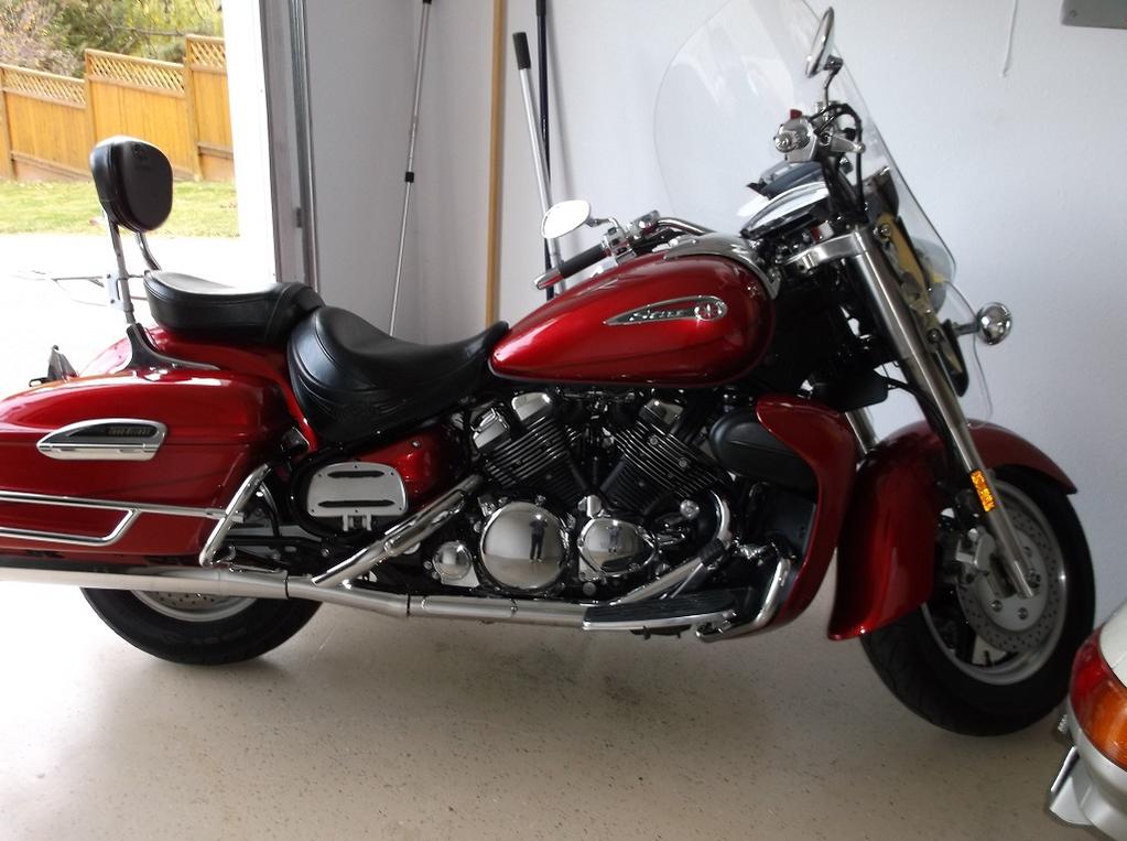

What I know from the previous owner is: He tried to start the bike and there was a loud "pop like a backfire" and the engine would not turn over. He thought the battery was bad and installed a new one with the same result minus the big pop. Then he took the bike out on the road and tried to jump start it down a steep road and still no go. What I know from ripping it apart. There was rust in the right rear cylinder. right rear connecting rod was bent badly and had hit and cracked the bottom of the cylinder. What I suppose happened. They put the bike away for the winter hot and perhaps a bad head gasket weeped enough coolant into the cylinder to cause it to hydraulic when he tried to start it in the spring.
The new motor is a 2008, I'm using 20-50 Castrol motorcycle oil. Would the 09 and 08 clutch baskets interchange?
I have a 2009 RSTD that I bought with a bad motor. I finished replacing the motor yesterday and took the bike for a 25 mile test ride. I've read about the "whine" but didn't know what to expect. Cruising along, all is fine and nothing out of the ordinary. When accelerating up a steep hill in a lower gear it can be REALLY loud (I'd guess the noise peaks at about 3500 rpm) I'm not too worried about it, do they all do that? Is it worthwhile to change the clutch basket ( I have a spare from the original motor). BTW, super nice bike, I'm really impressed! Makes my 2016 Road King feel agricultural !!
