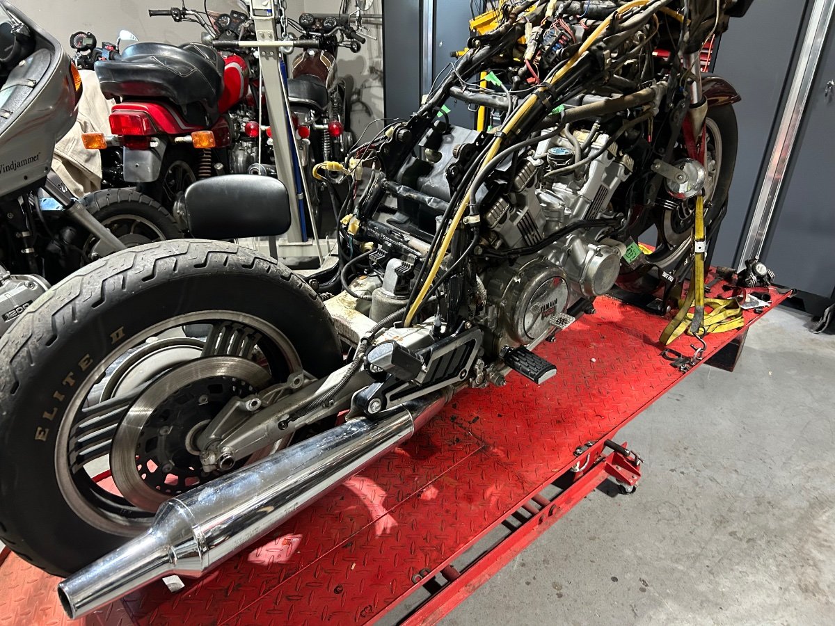

All of these parts are in excellent condition. This is from a 1983 venture xvz1200. I am referring to all the plastics including saddlebags, trunk and fairing., the color is maroon. Other parts include rear taillight plus bracket and fender. All of the chrome pieces as well. I’ve stripped the bike down to its bare bones and will be turning it into a bobber of sorts. Again… these parts are in excellent condition. I am selling everything together.. will not mail individual parts. You will have to come and pick up the parts. I’m asking $250 for the entire bundle. I’m located in Oklahoma if you are interested. Pm me for more info. Thanks

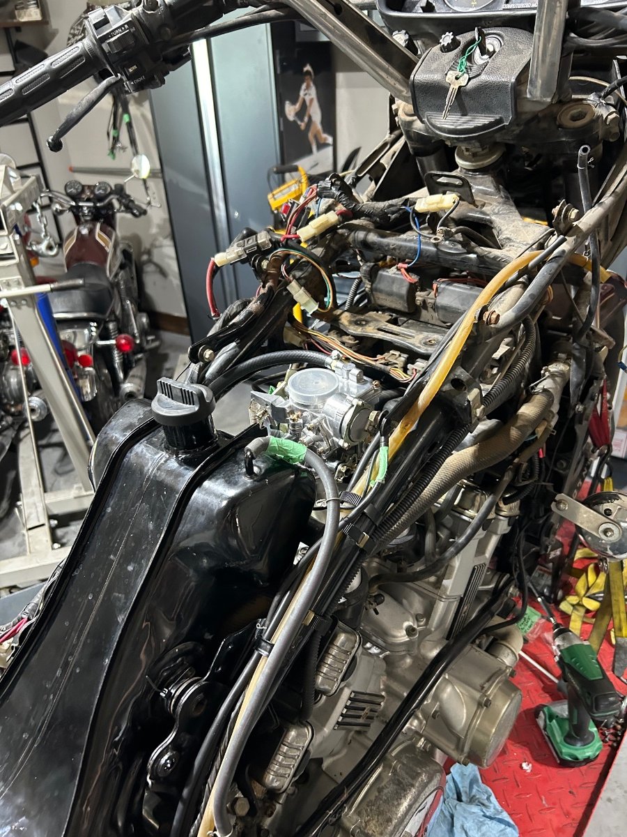

It couldn’t be this simple!! Positive battery wire was loose… really?? She fired right up! But….. tach is out. I did check #2 and it does have spark. Bike is back up and running though, will keep assessing on the tach. -
Bike was running great and now. …. Urgh puff of smoke / loud pop coming from single carb . Bike does not run. All electrics work . I have spark on all 4. If my Cdi was bad , I wouldn’t have spark, correct? any help is appreciated.

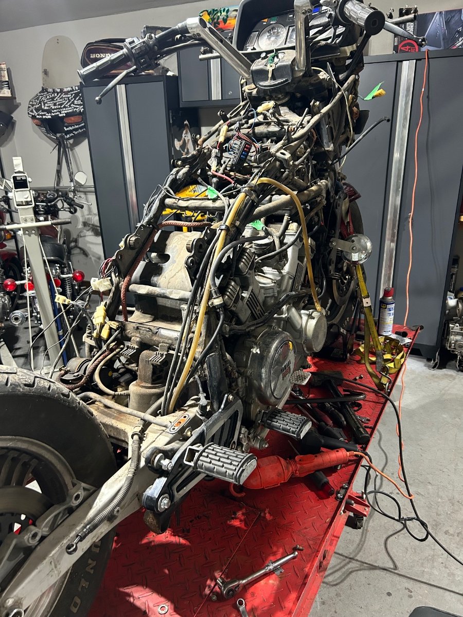

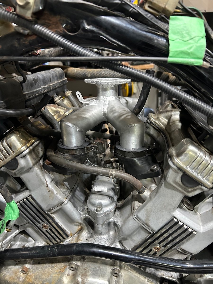

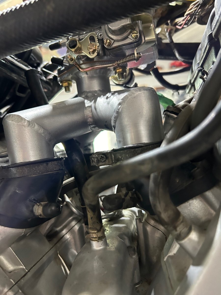

Okay….. lots have happened in the past week. Completed the single carb and she ran beautifully, then…… started misfiring and my tach is now not moving. I checked for spark and 3 plugs have spark but no spark on front left plug. I put a new plug , boot and plug wire in and still no spark. I then checked the coil by swapping wires and I got spark . I ordered another coil, if that doesn’t fix it , will have to get a tci module I guess -

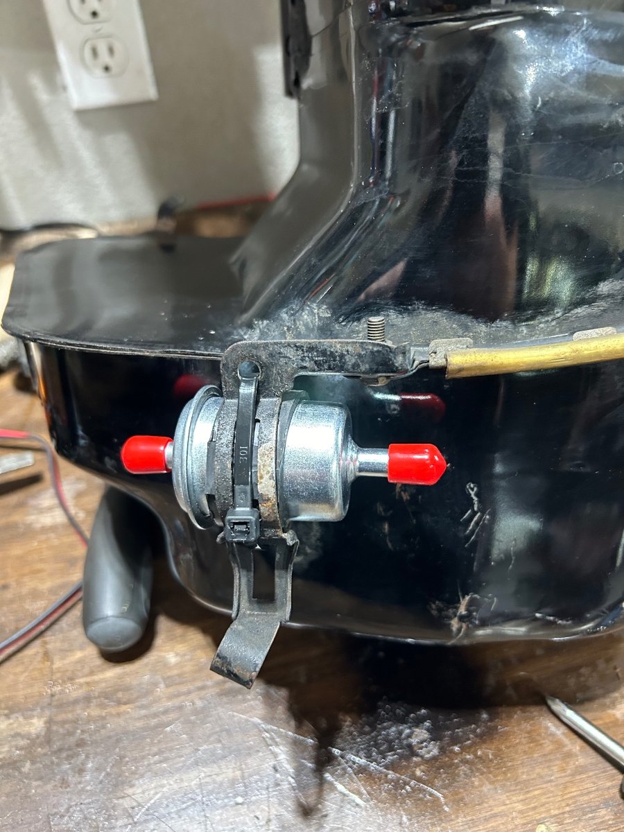

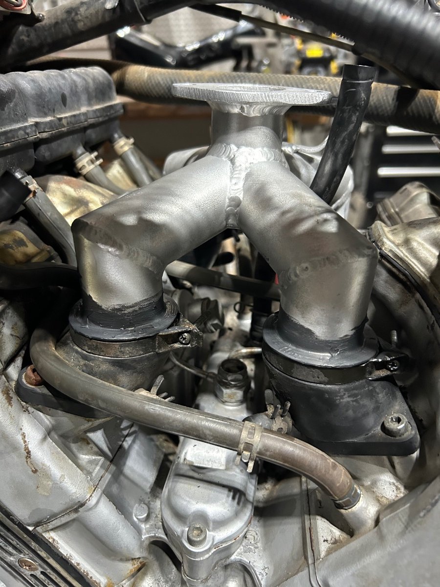

I’m back and better than ever Restoring the same model bike you guys helped me with, back in 2019. Some of the names I remember from back then, if my memory serves me correctly:Venturous Randy, Cowpuc, skydoc just to name a few. Anyway, current bike has not been started since 2009. It was stored in a shed so that’s good news! I did choose to go with a single carb this time. will keep you updated. I’m almost ready to fire her up
