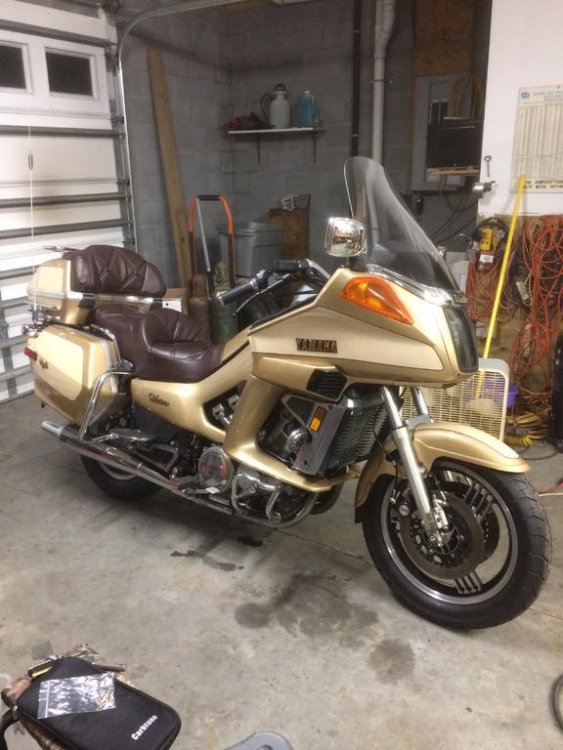

I went to do a check of the right front cylinder plug wire, went to pull it off the plug and found it was sitting on the plug, but not seated. Well over an 1/8 inch off actually touching the connector on the plug. Maybe that had something to do with the failure to warm up like the others, huh ? Sloppy of me, that bit. I'll jump on her for a ride and see if it isn't all better now... It's clear to me new caps and wires would be a good idea anyway. They're probably originals. -
Thanks to many contributors and in particular, Cowpuc, I've gotten from torn apart to back together. Another '83 is saved from scrap and ready for the road again. Now, the final part. The right front cylinder takes a bit longer to heat the exhaust flange beyond the touchable temp. The other three heat up quickly. With no tags and no helmet in this helmet state, I haven't gotten to really ride it yet, but zipping up and down the street it seems OK. I might have a slight exhaust leak at the collector but nothing I can see. It takes a full two minutes to run evenly without the choke. It will not rev until this two minutes are up. Then all seems normal with a little less power than I remember, however it's just barely up to operational temps. The carbs are cleaned and synced. Pilot screws are all at two turns out. ( I'm going to give the right front carb another 1/2 turn. ) So my question is... I have the colortune plug. The "Bunsen blue" range seems to be from 1 1/2 turns to 3 1/4 turns on the pilot air screws. This is way too wide for me. I compromised with 2 turns and may go 2 1/2. I have no access to EGA equipment so I'm thinking I'm reduced to checking the plug condition for the proper medium tan color. Any quick ideas on how to chase the pilot air screw to a good setting or am I already there for all intents and purposes...

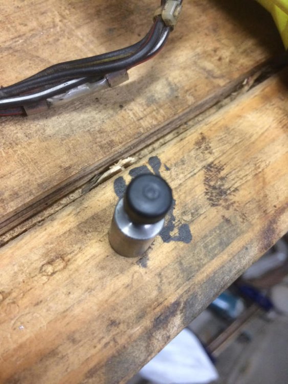

I've gone through the Dis-assemble - clean - reassemble - fail - dis-assemble -clean etc. cycle five times. No progress. I have noticed that the vent and front fork solenoids have a snap to them when I decrease pressure and the rear shock solenoid does not. Perhaps I have a voltage drop through poor solder joints in the control panel. There are no obvious or even subtle flaws in the valve body. All the solenoids work on the bench. Guess I'd better check the voltage to them on the bike. It should click when I decrease the rear shock pressure. Well something should and I got nada. Back to the book... -
class plunger solenoid cap
Vickersguy replied to Vickersguy's topic in Venture and Venture Royale Tech Talk ('83 - '93)
It's quick to inflate, quick to deflate. The front forks hold pressure for several hours, very slowly leaking out. Rear shock deflates in 60 seconds. The reed valve in the valve body is holding, so that leaves the solenoid valve seats. Also the plunger caps. If someone has ever found new caps, I'd love to know the source. -
Per Prairie hammer's instructions, I cleaned up the seats in the CLASS valve body. They are fairly clean and square now, the corrosion is gone and the plunger contact area is shiny instead of grey with oxide. The challenge is to fix the rubber cap on the solenoid rod. I'm thinking a thin skin, 1/64th inch thick, of neoprene rubber, or maybe 1/32 , glued on with that rubber cement used for bicycle patches. With the groove that spring pressure and age has left in the plunger surface, being offset from center and all, i doubt it will seal even after what I did to the valve seats. Ideas are welcomed on this or a source for replacement caps. They are 8mm. dia.
