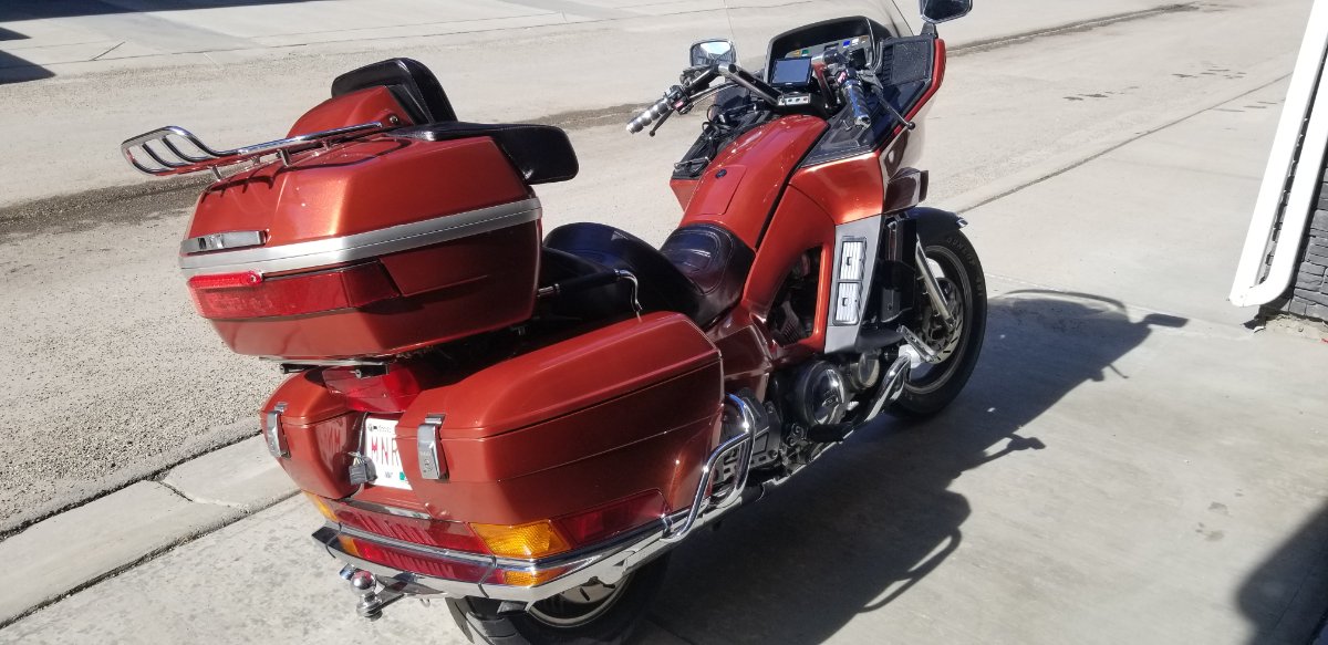

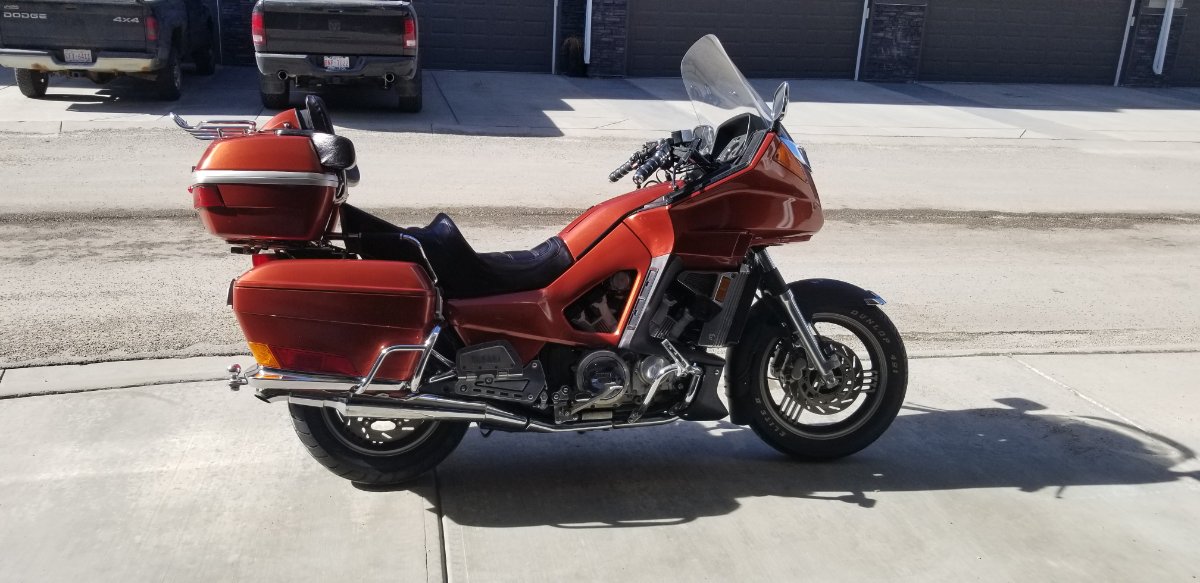

Awesome color.. I just painted mine this past winter.. 2020 BMW paint code. Nice , fresh and looks new, not 25 years old LOL -
