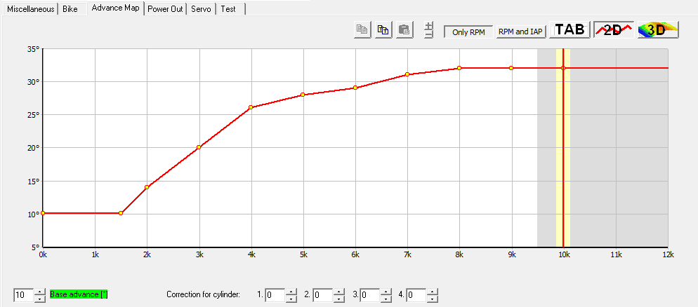

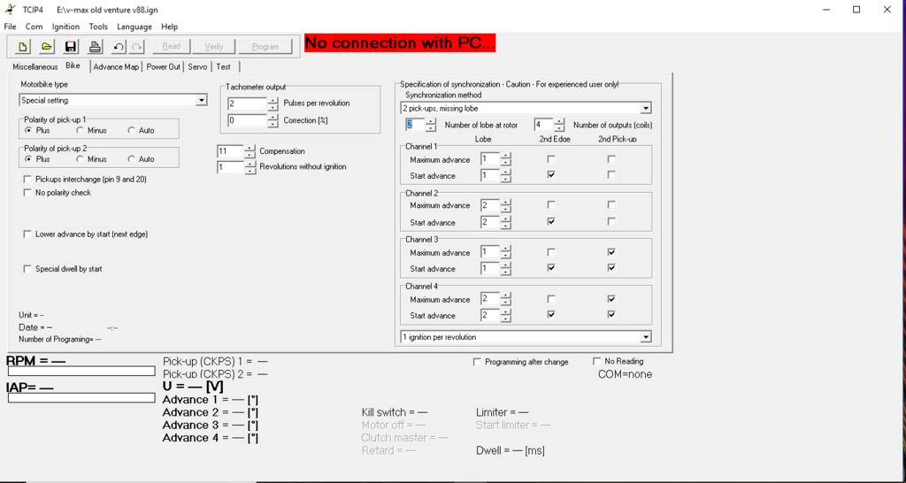

So Another update. I have not yet plugged my laptop into the computer but I did install the software with the disk they provided which also included the profile that is currently loaded. Here are the screen shots of it. Pay close attention to the green boxes in the upper right hand corner of the first image. This is how it reads the boost sensor. And while I know that the kPA settings are off (the yamaha manual refrences 5.3 - 27ish kPa), the voltages are correct for what a 1983 venture boost sensor gives off (or at least what the 2 that I have mesure at atmospheric pressure and under vacume. So it does in theory work and it feels like it works. I will, (once i finish with tuneing carbs and such) try and get some DYNO time like the guys earlier in this post did to post more scientific results. But as I see it now, it looks like IGNITECH has got a pretty good handel on the required programing for these bikes to get the most out of them with no modification. So for any of you having TCI issues, I highly encourage you to just bite the bullet and get one of these units. The amount of time and energy you will save will make it wel worth the cost and get you back on the road much quicker than trying to repair a TCI that just wants to RIP. [NOTE] If anyone has one of these units running on an 83' (I'm not sure it works on newer models but you can try at your own risk) and wants this profile, PM me and I'll send it to you. -

It should work. As far as I understand it, its the 83' that is hard to get working right because it has a different boost sensor than the 84's and up. But it seems like they have gotten it figured out. I can defnintly notice a diffrence when running the new sparker with and without the boost sensor connected. That said I do think that it needs to be advanced just a little more as I get some afterfireing. But that is also likely due to the fact that I am running premium non-eth fuel and also needing to burn out all the crap in the system from it sitting for 5+ years and running like garbage before now. It does seem to bet getting better with more miles. Just be sure to let them know the exact year and model of your bike and you should be in good hands. Later this evening I will plug my laptop into the new sparker to get a better idea of what the programed curve is and how its reading the boost sensor. Will repost once I have results. But at any rate, defnitly get it. Even it it required a little tweeking or the MAP sensor mod that has been mentioned earlier in this thread, it is completly with the $$ to have a reliable sparker that you have the option to custom tune to YOUR bike (as all motors wear a little differently and can sometimes benefit from a custom advance curve). And it cant be beat with a 2 year warranty. Try finding a stock TCI with that! -
