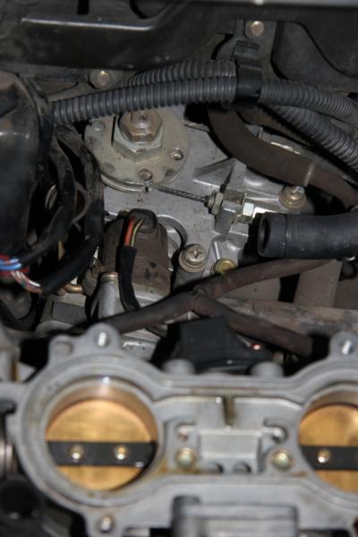

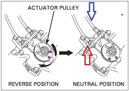

Sam, per your request, I sent you my phone number in another email, but here it is again: 256-429-8623 NOTE: Please don't do any of this until we speak. If after trying all the other recommendations, you need to manually turn the reverse actuator to the neutral position if it's not already there. This is done by removing the lower front cowl and the upper black cowl behind the forks. You will then put a large crescent wrench on the actuator nut and turn it slowly clockwise until it's in the neutral position in this diagram (see attached). You need to do this with the key off and the reverse shift switch out. Once you get it turned, turn on the key and see if the reverse light still flashes. The neutral cable is the one the blue arrow is pointing at and the other is the reverse cable. The purple dots are the lead cable ends in the pulley for positioning reference. See attached picture!! Edit: Sam, I hope you get this email before you begin taking more of your bike apart. After we spoke on the phone I decided to locate a few pictures and send you them so you can see what you will be getting into. It WONT be an easy task if the reverse module went bad, and you have to replace it. I would not even tackle it myself swapping out the reverse module. To do what you and I were talking about - turning he module to the neutral position, I think you / we can do...but if the module needs replaced, you will be in a pickle because you will have to put the whole bike back together before you can take it to a dealer to fix it. See attached pics: one picture shows the location (somewhat anyway) of the reverse Module and the last picture is what I need you to pay attention to, for it shows how much you will have to tear the bike apart to "change out" the reverse module with a new one. I cant help you on the change out because I have never done it before.............. Im going to try to call you again right now too.. Eck -

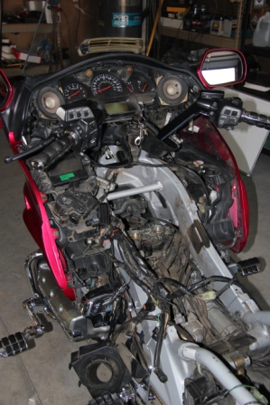

Sam (You quoted); Eco I have the relay container loose but I have not been able to get to to the relays without pulling on the wires. I how do I get to them? Thanks so much for all your advice. Sam Sam, Relay "A" and relay "B" are down inside of a rubber protective boot. Both relays have their own rubber boot. To release the rubber boot from the frame, the rubber boot "slides" over ( or hooks on to) a small metal tab. You have to "push upwards" on the rubber boot to release it / slide it off the metal tab. Once the rubber boot has been removed from the holding tab, you must push UPWARD on the wire harness as you pull DOWNWARD on the rubber boot to expose either relay. You must slide the rubber boot down the wire harness far enough to where you can expose the (6) wires attached to it. BEFORE you pull off any wires please make a quick hand drawn wiring diagram as to where the (6) wires go... Note: Relay A can be used in place of relay B and relay B can be used in place of relay A. They are interchangeable even though they have a different part number. They are color coded and that is the only reason for the different part number between them.. Edit: Sam, With the tests you have been doing so far, I do not feel your problem is either one of the starter relays.. I really feel it is just stuck in reverse... I would be rocking that trike back and forth vigorously with the key on, hitting the reverse switch then the starter switch working back and forth on the switches as I rocked the trike (vigorously), and having clutch lever pulled in at all times. If this does not work I would be looking at a dealer for help from here. -

Sam, You sent me an email stating you have to pull on wires to see the relays..I sent you a quick reply stating same as here (see below). STOP.. dont pull on any wires...there should be NO need to pull on any wire. If you pull on the wires you have a darn good chance of pulling the wires off the relay and I have NO idea how they go back on with out looking at it before the wires come off to make a hand diagram. BEFORE you go any farther, please try this: I need someone to sit on the trike, pull in on clutch lever and hold it in, turn the key to the on position, reverse lightg should be blinking...now push IN on the reverse switch and see if it will go into reverse, you may hear a click ( I hope so anyway).. the reverse light should stop flashing but remain on. (the light stops flashing). IF the reverse light does stop flashing, push in on reverse switch again to take it out of reverse. The reverse ligth should go out and then you should be able to start the bike and then move shifter up or down. Please let me know how this works before you do any electrical investigating / disassembly. -
