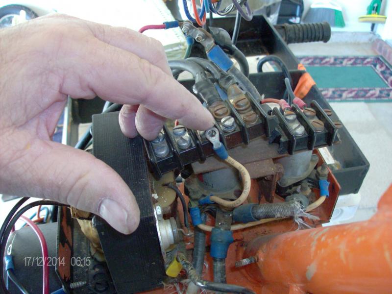

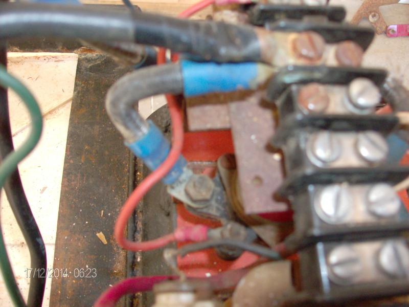

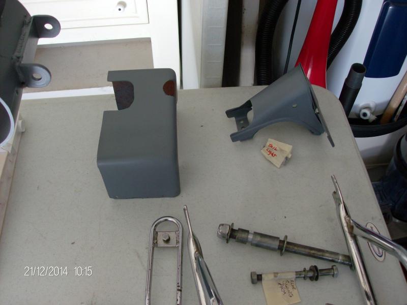

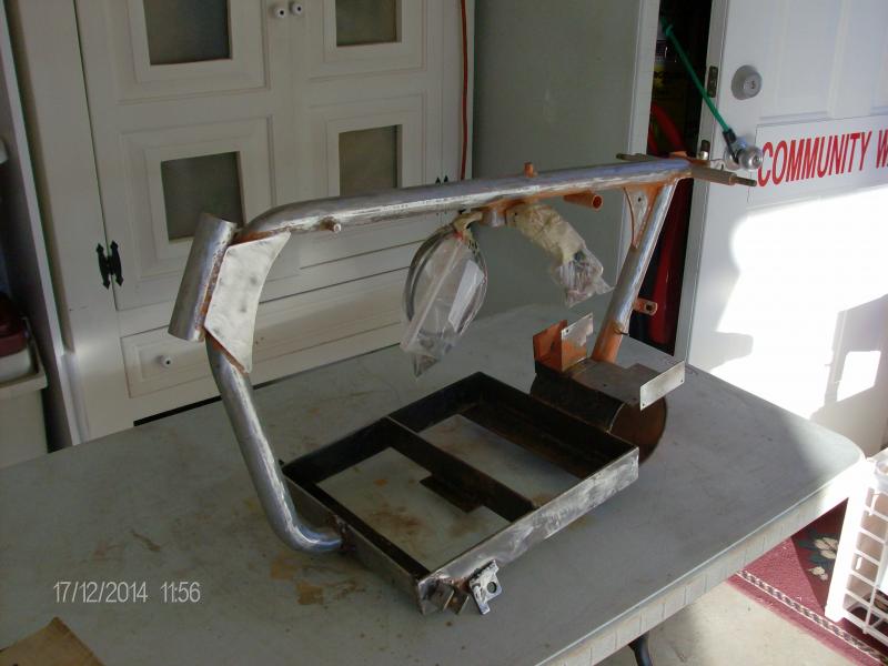

Follow up - progress on the rebuild of my Auranthetic Charger. Date: 11-24-2014 Sanded down all remaining parts such as rear fender, frame, electrical box cover, headlight bucket, tail light / license plate bucket assembly, masked everything off and sprayed primer on all parts needing paint "except for" the gas tank. I dropped the gas tank off today at a print shop and they are going to duplicate the one decal that is on the tank for me. Once the decal is made I can sand down the tank, prime it and then spray everything with a 1971 Hugger orange color which is about as close as it gets to original. Whoever played with the wiring on this thing needs his butt kicked. So many splices in the wiring. Like one wire which is only 6 inches long yet it has three red connector splices in it. Don't know why they didn't just replace that one wire...in to much of a hurry and didn't have another piece of wire I guess. It will be right when I get done with it. I am not sending the chrome parts out to be re-chromed.. I am not going to go thru that expense. The chrome parts are cleaning up really well though.

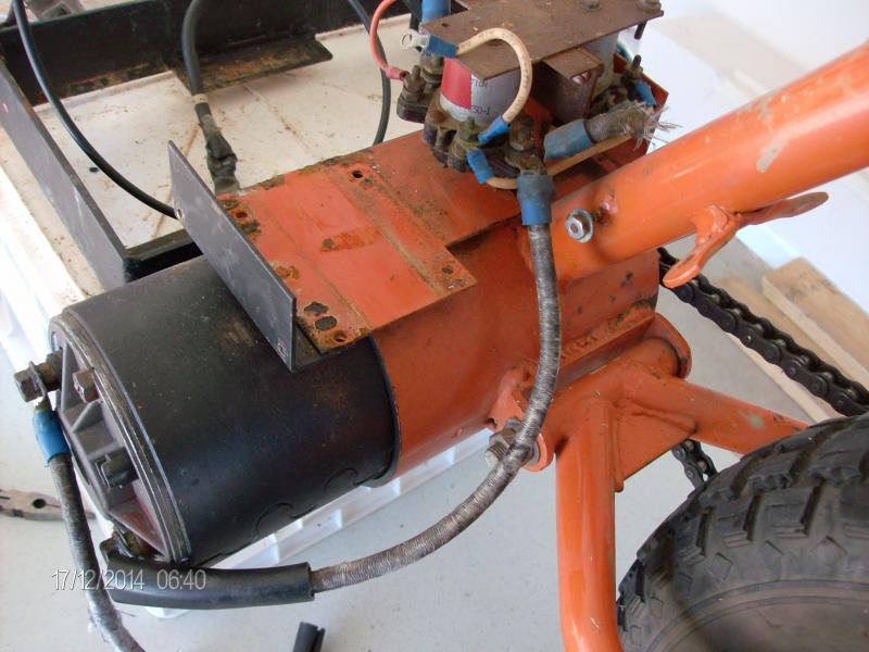

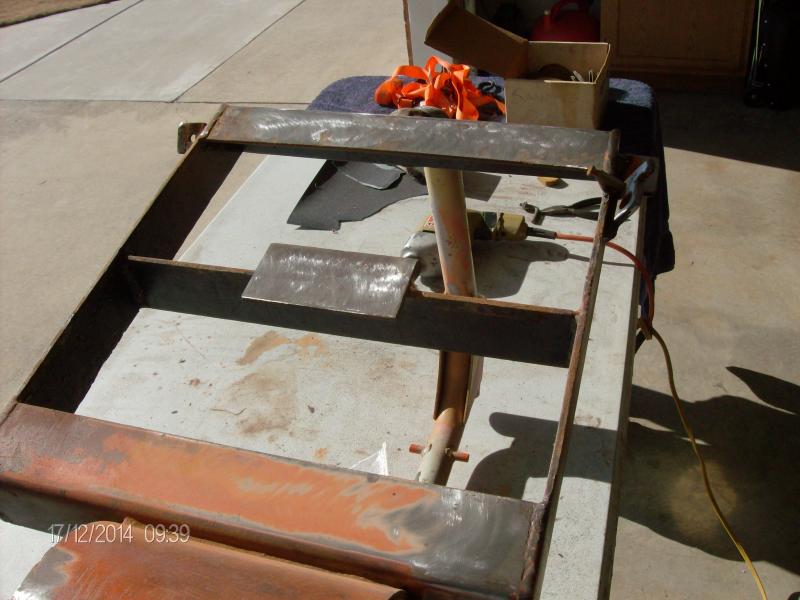

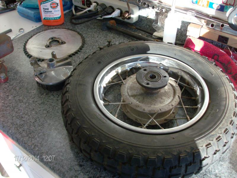

Well here we are again- it's 11-20-2014 and I spent the day continuing the tear down of the Auranthetic Charger Orange. As of today I have remove every single bolt, washer and nut. Every single wire. 100% of everything has been taken apart. I removed the rear wheel, swing arm, rear shocks, entire wire harness after identifying where every wire goes or attaches to. I removed the electric motor. I then started sanding down the frame. Tore the rear wheel apart, cleaning the rear brake shoes, rear hub, and rear wheel including every spoke on the rear wheel. Check out the pics slowly and you will be able to tell the difference between the " before" and "after" elbow grease that was applied....... Hope you enjoy the pics near as much as I enjoyed the tear down. Next phase will be sanding down every "orange" part and getting them ready for primer and paint. Frame is completely sanded down to bare metal and ready for prime. As I removed each part off the frame/bike, I cleaned it buffed it out, waxed it, and marked it as to what it is and where it goes and included my own hand drawings to ensure it goes back in place upon re-assembly. As you look at the pictures you can see that little by little the frame is becoming bare...I hope you enjoy following me along on this as much as I enjoy doing it,. Thanks for looking!! Might be better to start at the bottom picture and work up to see actual progress of the tear down. Eck

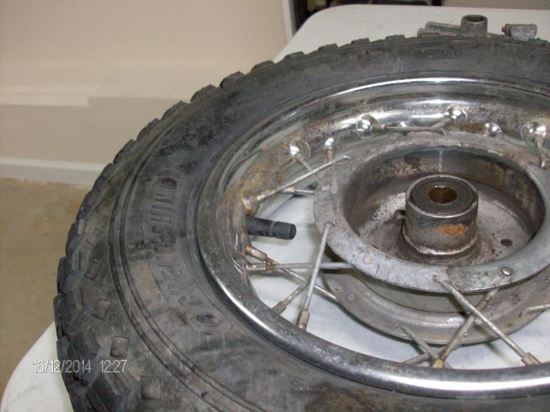

Took off front wheel front forks/ tubes triple tree, cleaned, lubed and waxed all those parts. Notice how rusty the front wheel "was" and what it looks like now after cleaning/ waxing.. what a job. Front brake shoes have lots of meat on them yet. Disassembled, cleaned waxed, applied grease where needed, and now ready for re-assembly when ready. Rebuilt front forks, cleaned, waxed those, bearings are fine, will be cleaning and re-lubing those before re-assembly, Been marking a few wires as to where they go and what they are for before disconnecting them. I plan on replacing every wire from start to end to ensure they are right. Handlebars were a little rusty but a little more disassembly of wires and elbow grease and they turned out nice as seen in pics below. I removed the rear fender, tail light housing and light assembly including wiring. Wont be long and I will be down to the frame. I have been taking pictures before I disassemble anything...Again the battery acid took its tool on the paint job.. I am in a dilemma on striping and repainting it or just re-assembling it and maintain the original paint job. I have one decal on the gas tank that I can not find a replacement. I DONT want to loose this decal..Applying heat and careful removal may be in the future as an attempt to remove it from the tank, but I am not certain this will work. It is a one shot deal no matter what..So that is why I am thinking of leaving the paint job as it is.. but again, I am not sure what I will do yet.. DUH...............

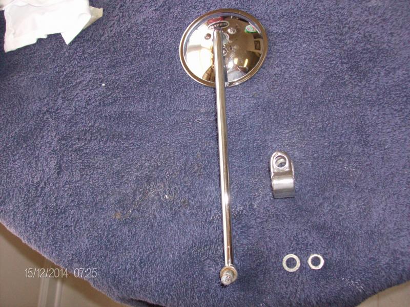

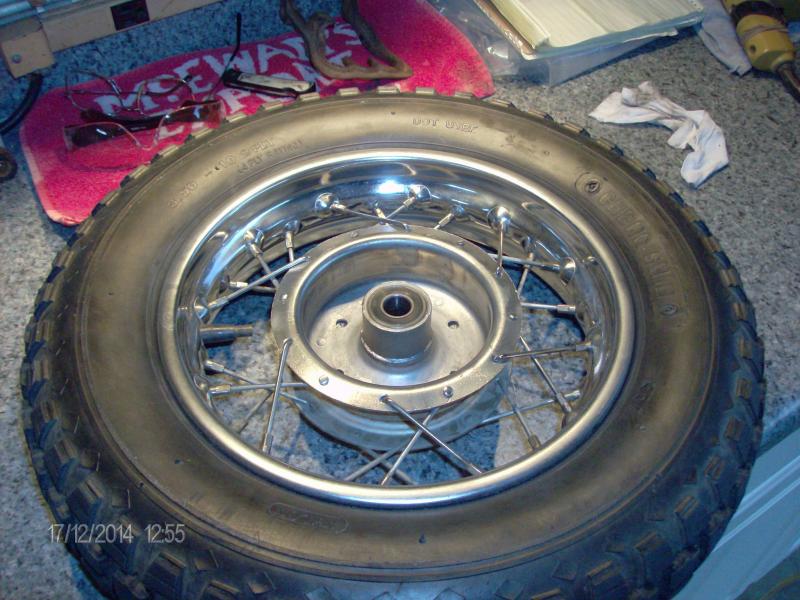

I knew about the aluminum foil trick years ago, however I don't do it the way it was posted though, but close. I clean the part first using soap and water, dry it, then I use chrome wax and apply a small amount on a small 2" x2" piece of foil and rub the rusted part. The amount of effort seems to be reduced and the satisfactory end results are achieved as seen in my pics above. Using water and aluminum foil works. When you see the grey color, that is the paste that forms to remove the rust. I just go ahead and apply a chrome cleaning paste to get going faster...

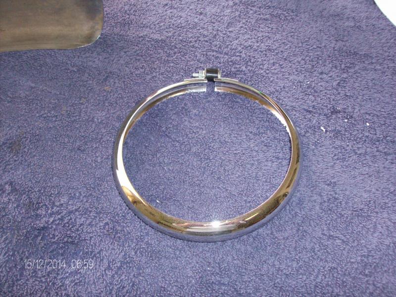

Being it is cold outside, I decided to bring in some chrome parts and se if I could clean them up and give them a good waxing.. What-do-ya-think? 1st pic is the "before pic" of my front fender - then the next pic is the after cleaning and waxing of same fender. Didn't take before pics of mirror or headlight rim, but here they are now..
