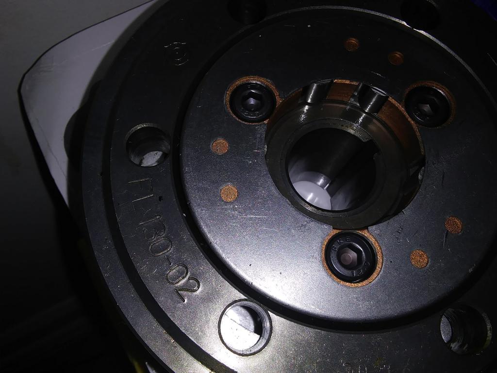

It seemed smooth to me. Danos is fare price. I am thinking a project when winter comes back. I don't like doing a job twice but sometimes you have too. Plus I have to replace Stator and find out why my cooling kit still did that to stator in 3 yrs Never ride faster then your angel can fly. I am as free as the wind on my face.
I am using voice to text right now so I'm going to have to come back and edit this later but there is a few cracks in there but all the little springs and little push rod thingies and I guess the engage bearings or whatever they are all came out of this clutch when I pulled it off put got the flywheel come off Never ride faster then your angel can fly. I am as free as the wind on my face.
When I took a look I seen cracks on this side of the clutch in the rotor, I did not have to apply any heat and all three bolts where in tight!! But this has been a fun adventure and you guys followed me thru it, Special thanks to the fool, Dano, Carl and Cowpuc and of course the BOSS fits in there somewhere I am sure because without this site I would probably be out yet another grand or so. Tell you that $12.00 a year is cheap technical support. The tie strap worked good holding her back from putting holes in my Garage wall. After pulling the clutch from the rotor, the cracks were more pronounced. Also when the rotor came off the crank all of the pieces except for one came out of there prospective homes. Never ride faster then your angel can fly. I am as free as the wind on my face.
I got the time right now too... Gotta wait around for insurance adjuster to come look at the truck. Plus ain't like I'm going anywhere with no starter. I tell you the way it sounded well I'm sure you all know that sound it makes. Makes it seem as if your gonna have parts come flying out of that cover. Never ride faster then your angel can fly. I am as free as the wind on my face.
