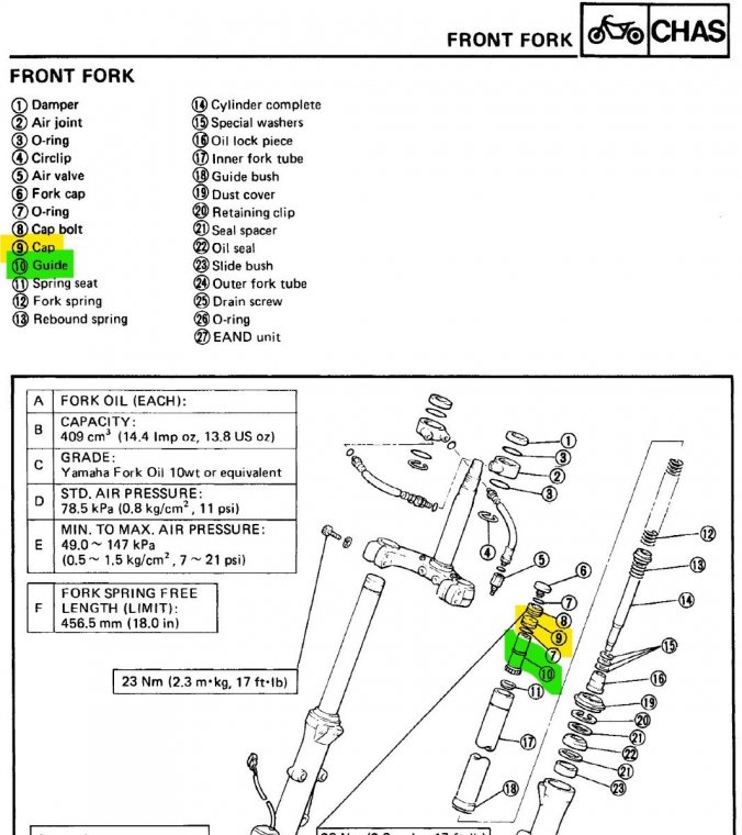

  6. I checked my notes from my 2005 installation of Progressive springs. The PVC spacer was 1 1/4" tall. I didn't use it. Instead, I installed the OEM metal spacer with the o-ring that Prairiehammer referred to as the "cap" in the above photo. It is approximately 1" tall. I'm 175 pounds. That shorter OEM round metal piece is indeed called the "cap" and the original longer spacer is called the "guide". Even with Progressive springs, a Superbrace, and a Furber Fix (steering stem washer replacement), I don't like this bike in higher speed sweepers either, especially if there are bumps. It's worse at lower speeds. The front end seems bouncy and untrustworthy. There seems to be a lot of uncontrolled weight up front in the steering assembly, forks, calipers, tires, etc as if the forks are undersized and not stiff enough for this bike. I notice this if I'm at a stop and I give the handlebars a rapid, sharp jerk to one side or the other: I can feel the oscillations in the handlebars until the momentum dissipates. Problem is, this is my first big bike and it has been my first big bike for 20 years, so I have nothing to compare it to. Maybe this is just normal for a bike with 1980s technology and engineering. Following intently.

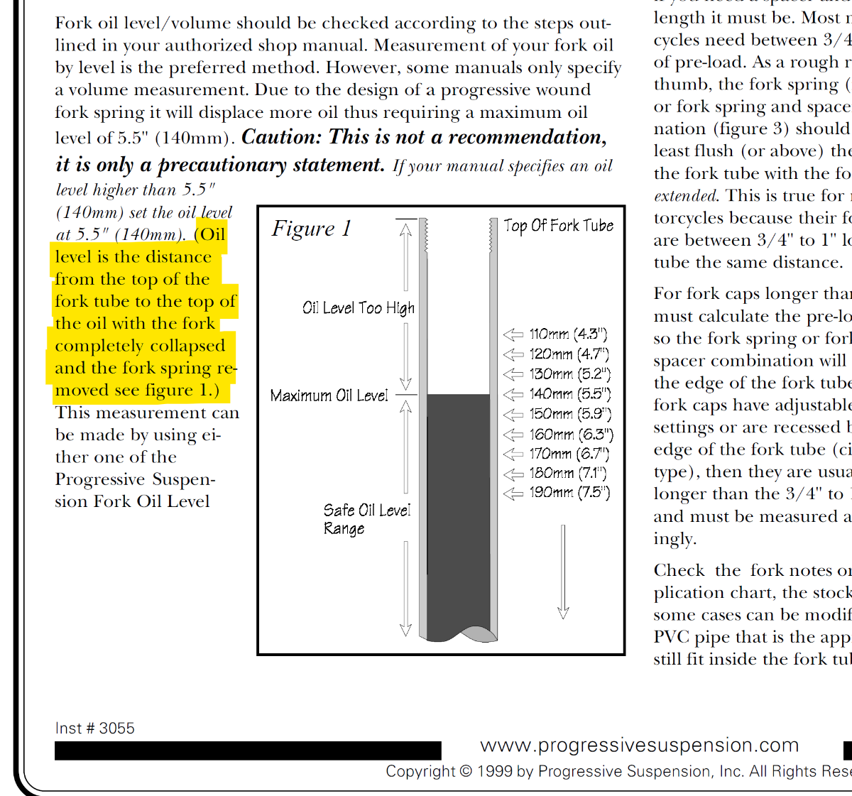

  9. In the instructions that came with my springs back in about 2004, Progressive says oil level should be measured with the springs out. Have the instructions changed since then? Oddly, I don't see instructions for the Venture in Progressive's current tech section: https://www.progressivesuspension.com/install-sheets/metric. @Pasta Burner: When I installed the springs back in 2004, I didn't think about exercising the forks to make sure oil filled all the nooks and crannies before I checked oil level. When I rebuilt the entire front end a few years ago, I put oil in and exercised the forks several times to distribute oil. I was surprised by how far the oil level fell from the initial fill. Something to consider if you go back in. Progressive Spring Instructions.pdf
