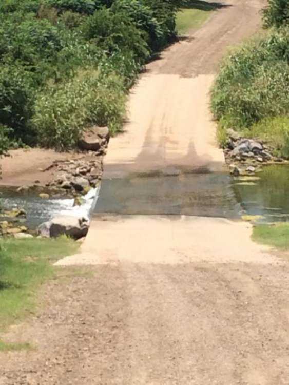

	The wife and I took a trip down to Witchita Mountains by Lawton Oklahoma. The GPS took us to some campground in the middle of nowhere which had a sunken concrete bridge with 2 inches of water flowing over it. We made across the first time but on the way bake the bike came out from underneath us. Luckily Diane and I got off with no injuries. It was so slick I could barely get the bike up and hold it. As we tried to pull the bike out, the water pressure was enough to scoot the bike across the slime and the front wheel slid off the bridge. Thank goodness there were a couple people that live right there and came out to help us. Bike survived with nothing but a small scrape on the bottom of the exhaust. So never cross an underwater bridge on a motorcycle.
