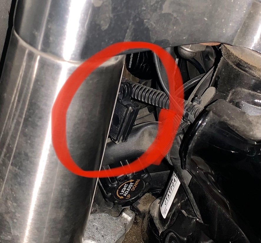

  3. Fixed! It was the connector pictured in my previous post. Put in a new one and everything is working normally.
  4. I have a new connector on the way. I’ll post an update when I get it installed.
