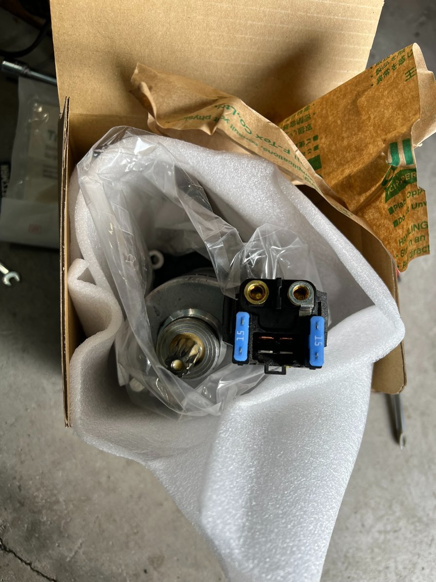

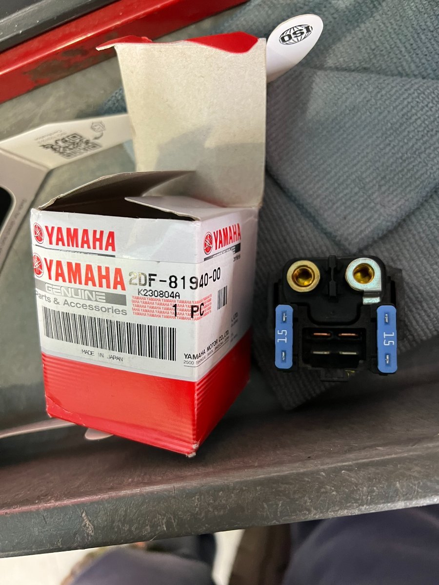

N3FOL Posted February 26, 2025 Author #7 Posted February 26, 2025 Error 12 Update: Called the shop and they stated that they may be able to work on my bike, but they are 2 weeks out. It is understandable that they are unable to tell me what is wrong without plugging it in their diagnostic tool and determine the issue. With that said, I am going to handle this myself for the meantime. 2 weeks plus is something I am not willing to wait and beside my bike is already out of the yamaha 5 year factory warranty. I called Partzilla today and was able to obtain OEM part numbers for the Starter and Starter Relay. Starter: 2DF-81890-10-00 & Starter Relay: 2DF-81940-00-00. I have no diagnostic tool on hand, but I plan to replace the relay first and see if it starts and then move on to install the starter. I think I'll have fun working on the bike. About to place my order online. 1

N3FOL Posted March 9, 2025 Author #10 Posted March 9, 2025 I went ahead and installed the new starter and it started right up. No more Error Code 12 on the dash. Nicer weather this week, so ride days are here. Replaced the starter relay as well, but I am keeping my original starter relay for future use. It may also be a good idea for me to stock one starter assembly just in case the dreaded Code 12 returns. I will also look into rebuilding the old starter by a Pro sometime this year. FWIW, this is pretty common for another starter to go bad on these bikes but it was not really so bad to replace it. Ride Safe. Old Starter and Old Starter Relay Old Starter Relay (still good) 1
