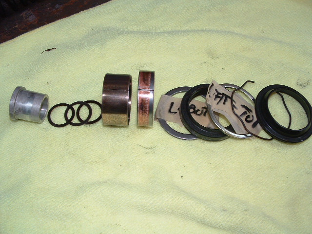

Chaharly Posted October 31, 2023 Share #1 Posted October 31, 2023 So it looks like ive found the steering head bearings. Do i need to replace the the races as well? I never really notice any looseness in my steering but at 90k miles I feel its due. I'm also due for a fork seal change and as I see it on Partzilla, it looks like there are 2 part numbers for each piece of the front fork assembly. I obviously need new oil seals which are part 6 and 36. Should I replace the dust seals as well? Looking at Freebird's tech write up, I see a copper bushing and another bushing towards the bottom of the fork assembly. Here's a picture with the bushings 21.jpg (640×480) (venturerider.org) I dont think i see them on the partzilla page shown here Yamaha Motorcycle 1988 OEM Parts Diagram for FRONT FORK | Partzilla.com Any advice would be appreciated. Thanks guys Link to comment Share on other sites More sharing options...
