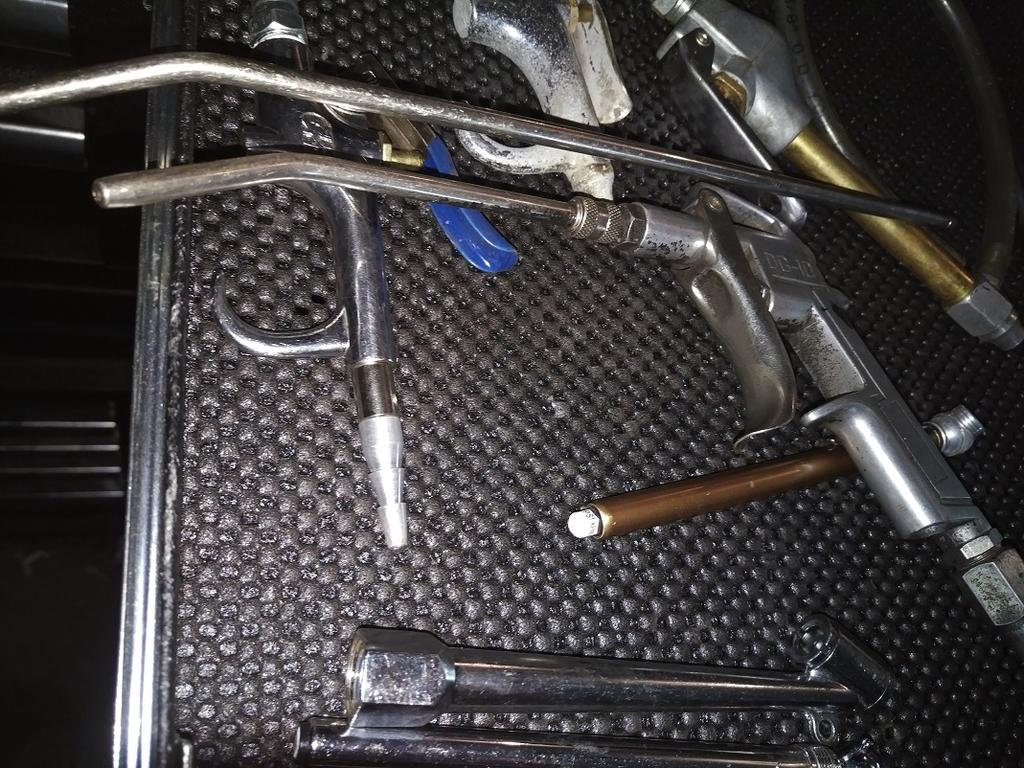

Its really not hard just be patient with the soaking time. That fine high pressure tip will help allot.
