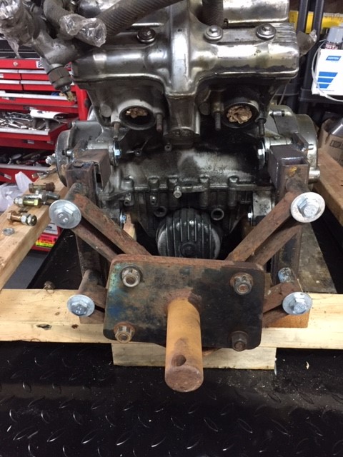

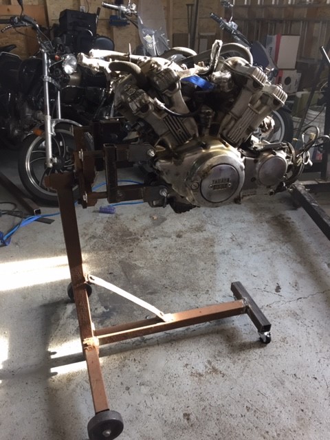

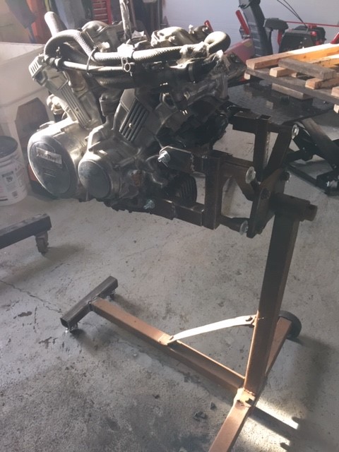

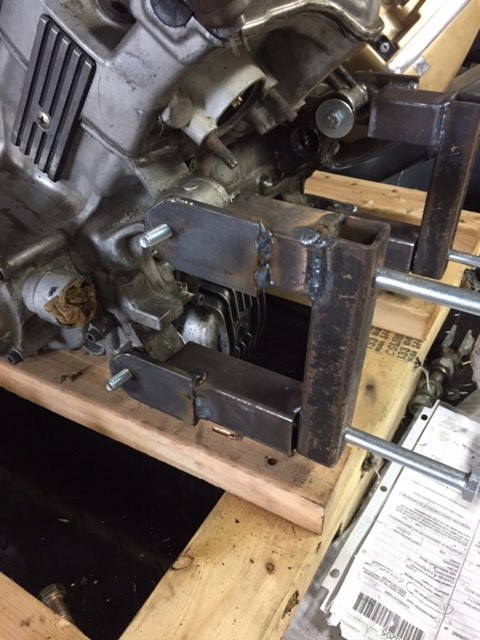

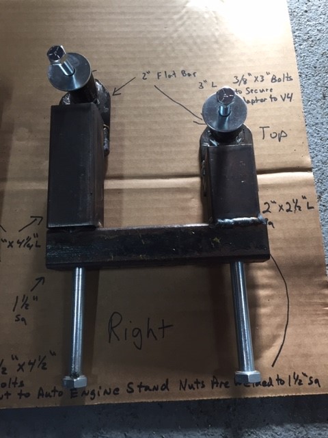

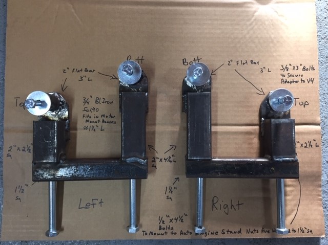

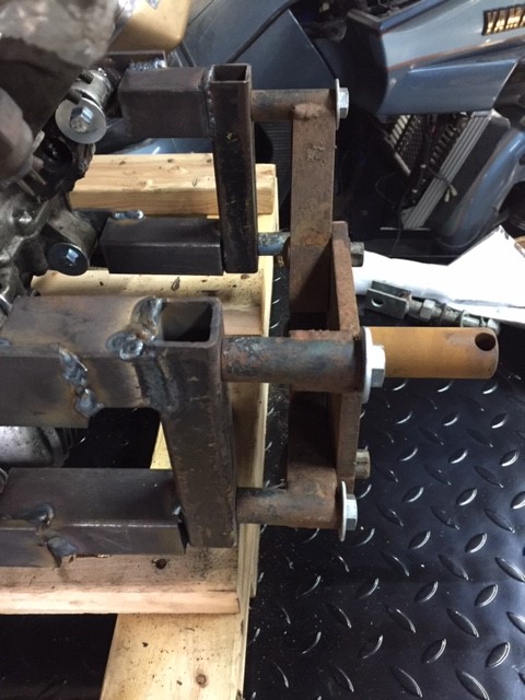

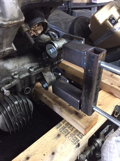

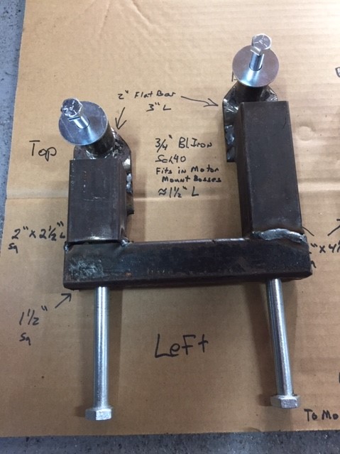

HermanK84VR Posted April 14, 2019 Share #1 Posted April 14, 2019 Hi Venture Members I searched for Motorcycle engine stands and or adapters all over the internet and was unable to find anything for our V4 engines. I decided to build my own set of adapters that will fit our V4 engines and be able to mount them onto a standard Automotive engine stand. It toke roughly an afternoon to build using Square tubing and scrap metal I had laying around here is what you will need 2 pces 1.5" Sq tubing 3/16" walls approx 8 " Long 2 pces 2" sq tubing 1/8" Walls 2.5" Long 2 pces 2" sq tubing 1/8" Walls 4.25" Long 4 pces 2" Flatbar 3/16" thick 3"long 4 pces 3/4" Sch 40 Black Iron Pipe, OD slides into the Engine Mount bosses nicely OD 1" 4 3/8"x3" bolts with Nuts and Fender Washers; these are used to secure the adapter to the V4 engine 4 1/2"x4.5" Bolts Nuts and Washers; these are used to mount the adapter to the engine stand the nuts are welded to the 1.5"sq tubing. Here are some pictures showing the built adapters Link to comment Share on other sites More sharing options...
