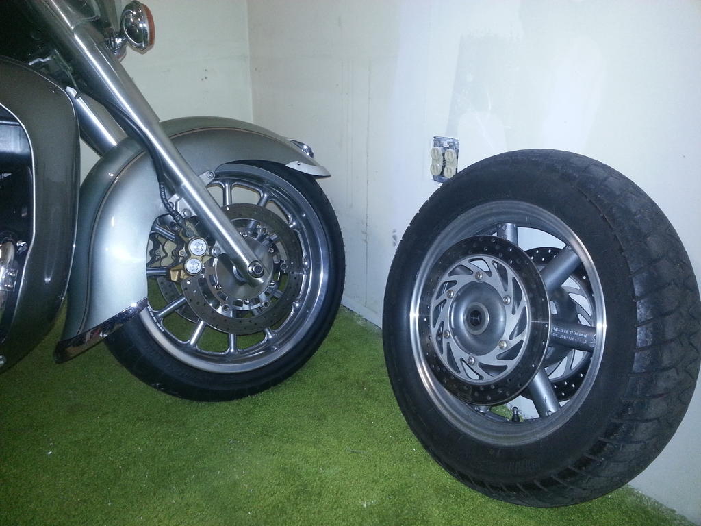

BratmanXj Posted February 2, 2018 #8 Posted February 2, 2018 Here's a photo of the calipers (that were painted Hurst Old's gold by the previous owner and I liked the look) and the Stratoliner front wheel and rotors. The biggest downside to the 18" front wheel is tire-life on a heavy bike. I did my research and decided to use an 18" tire designed for rear fitment on older UJM (CB750, KZ, etc) bikes. I get 10k miles out of a tire and they handle good...
BlueSky Posted February 2, 2018 #9 Posted February 2, 2018 Larger diameter wheels will decrease the mechanical advantage of the brakes.
