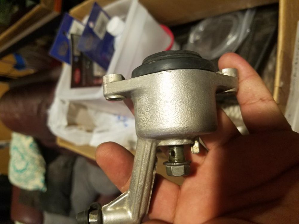

Update
I replaced the clutch slave cylinder took me 10 minutes to take it out and 1 hour to put back it slides right really easy but took me an hour to figure it out, unfortunately I striped one of the flat head hex screws and couldn't add dot3 to the master cylinder, if anybody have a recommendation of how to get it out I will very much appreciate it thank you.
Sent from my SM-G935T using Tapatalk
OK, first, WHY you stripped out the screw!! These are METRIC bikes and even the screws, especially the Phillips type are metric! Every time you use an SAE screwdriver on a JIS screw you are probably going to strip out the head!!! You need to invest in a set of JIS (Japan Industrial Standard) screwdrivers!! The main difference is the angle of the slots.
So, for now, you need to drill or grind off the head of the screw and then remove the stud with vice grips.
OK, after carefully re-reading your post, I am confused as to which screw you stripped. I ass u me'd you are referring to the master cylinder cover and not one of the slave mounting screws...
If you are referring to the master cylinder cover, plan on buying two of them as you probably buggered up the other head.
