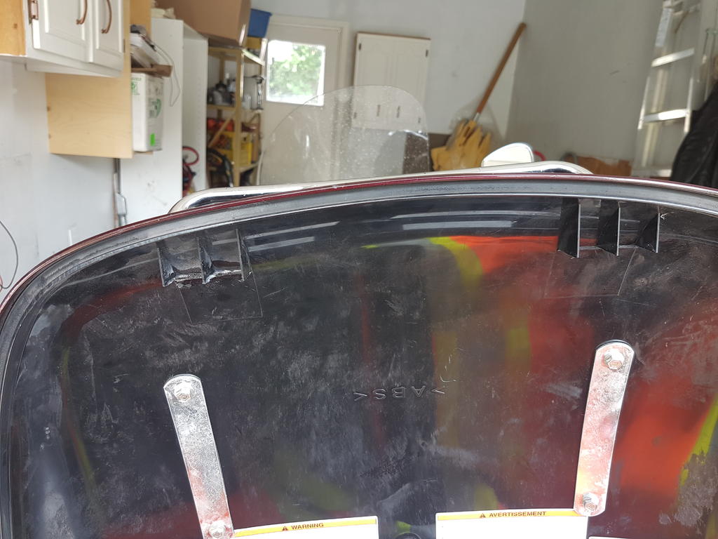

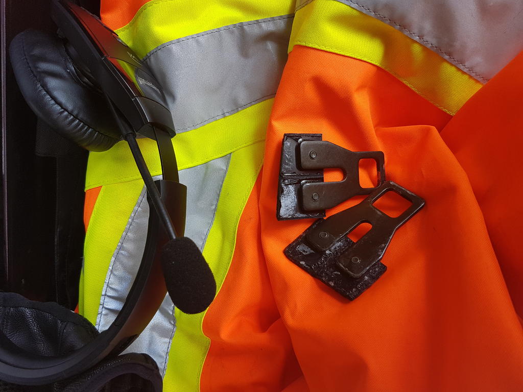

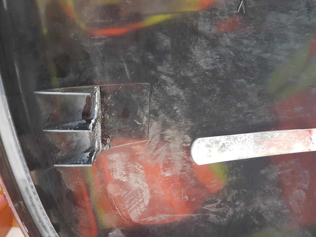

Cowboy270674 Posted August 12, 2017 Author Posted August 12, 2017 I added pics of the problem i have with the saddle bag for your imput thx in advance
camos Posted August 14, 2017 Posted August 14, 2017 I added pics of the problem i have with the saddle bag for your imput thx in advanceThat repair could be a little awkward to get properly aligned before the tabs get permanently attached. Once you get the correct position, making a solid repair won't be very difficult. Perhaps you could try taping the tabs in position using a couple of layers of masking tape on each side, inside and out, might make them solid enough to test fit the trunk lid part. If that works and as long as the plastic on the tabs is touching the plastic on the support structure then drizzle some MEK solvent at those points to bond the pieces together. The MEK will wick into the joint and stick the pieces together enough to be able to gently remove the tape after waiting long enough for it to set up. How long it will take to set will depend on the weather. It will be evaporating inside the tape so it's hard to predict. Once the tabs have been solidly positioned the connection areas will need to be built up to make it permanent. There are a number of ways that can be done. After removing the tape on the outside of the tabs, my preference would be to make up a paste of MEK and ABS and press it into any voids in where the tabs touch the support structure. Once that has been done the repair should be solid enough to test fit again. If it still fits remove the tape from the inside of the tabs and apply more MEK/ABS paste to build up the corners. To strengthen the whole structure, remove the metal parts and lay a piece of glass fiber cloth around the outside of the structure, sticking down with a thin paste on each side. After it all sets add some more to completely fill the weave of the cloth. Clean up any dribbles or pointy things with a sharp chisel and sandpaper. Clear out the mounting holes and remount the metal parts.
Cowboy270674 Posted August 14, 2017 Author Posted August 14, 2017 That repair could be a little awkward to get properly aligned before the tabs get permanently attached. Once you get the correct position, making a solid repair won't be very difficult. Perhaps you could try taping the tabs in position using a couple of layers of masking tape on each side, inside and out, might make them solid enough to test fit the trunk lid part. If that works and as long as the plastic on the tabs is touching the plastic on the support structure then drizzle some MEK solvent at those points to bond the pieces together. The MEK will wick into the joint and stick the pieces together enough to be able to gently remove the tape after waiting long enough for it to set up. How long it will take to set will depend on the weather. It will be evaporating inside the tape so it's hard to predict. Once the tabs have been solidly positioned the connection areas will need to be built up to make it permanent. There are a number of ways that can be done. After removing the tape on the outside of the tabs, my preference would be to make up a paste of MEK and ABS and press it into any voids in where the tabs touch the support structure. Once that has been done the repair should be solid enough to test fit again. If it still fits remove the tape from the inside of the tabs and apply more MEK/ABS paste to build up the corners. To strengthen the whole structure, remove the metal parts and lay a piece of glass fiber cloth around the outside of the structure, sticking down with a thin paste on each side. After it all sets add some more to completely fill the weave of the cloth. Clean up any dribbles or pointy things with a sharp chisel and sandpaper. Clear out the mounting holes and remount the metal parts.Thx i apprecate the info will have to look for the MEK PASTE OR ABS STUFF SINCE IM FROM CANADA I DO GET TO THE STATES SO GOING TO A AUTO PLACE SHOULDNT BE TO HARD TO GET AT Sent from my SM-G935W8 using Tapatalk
