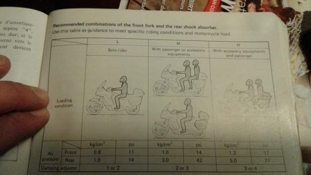

Grez007 Posted June 5, 2017 Posted June 5, 2017 1983 venture. It has 4 suspension settings and also a Schrader valve. What pressures can you run and is there a good pressure to start out at? I'm new to the ventures. I also read where people adjusted front pressure. Not having a Royale and having a standard one, am I able to adjust the front? Welcome to the forum, yes you should be able to air up the front forks, there should be a shraeder valve up in the black trim piece that surrounds the bottom of the handlebars and the ignition key hole. The 4 settings you refer to on the rear are for rear shock damping, 1being the softest and 4 being the hardest. According to my manual you want to set the damping knob on 1or 2 for solo riding. The manual also reads that the "LOW" setting is 11psi for the front and 14psi for the rear. The "MID" setting for the front is 14psi and 43psi for the rear. The "HIGH" setting is 17psi for the front and 71psi for the rear. I personally run front and back in the mid range for solo riding as I am a fairly heavy individual (250LBS). Just start at the low settings and work your way up if it feels too squishy. Good luck,safe riding. Paul

Grez007 Posted June 5, 2017 Posted June 5, 2017 (edited) Here's a crappie pic of my manual that puts it all in one place for ya. And yes what CASEYJ955 Said. A bicycle tire pump or something of that sort will do and not overwhelm the seals too quickly Edited June 5, 2017 by Grez007
