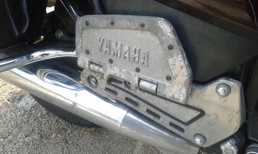

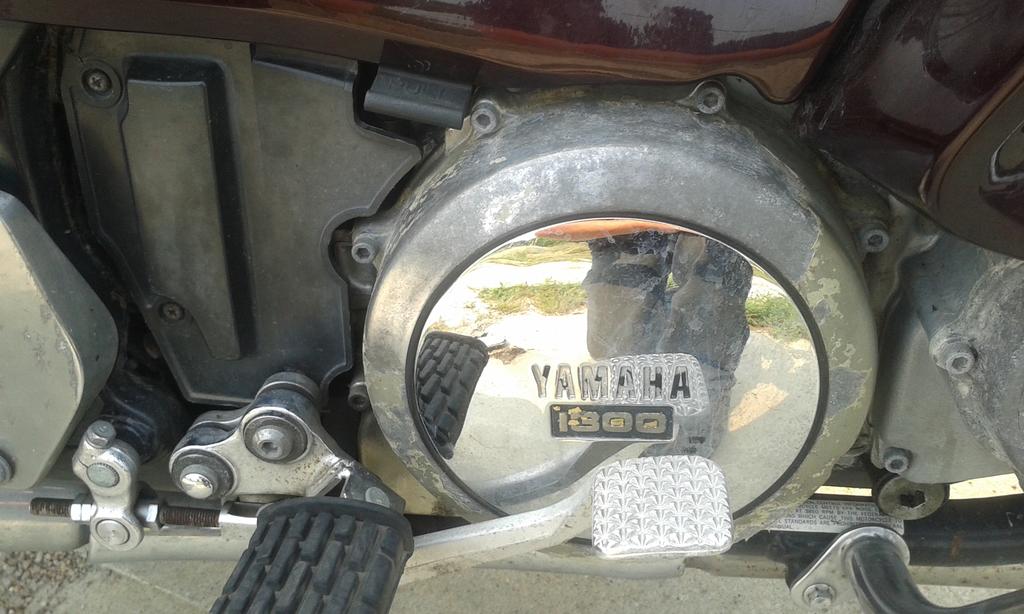

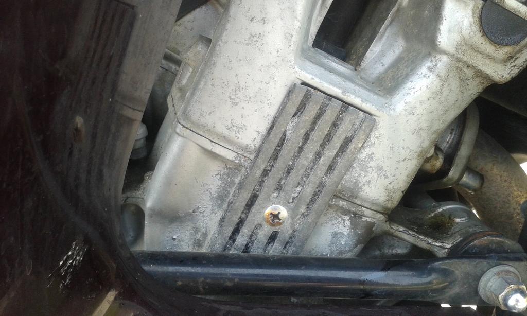

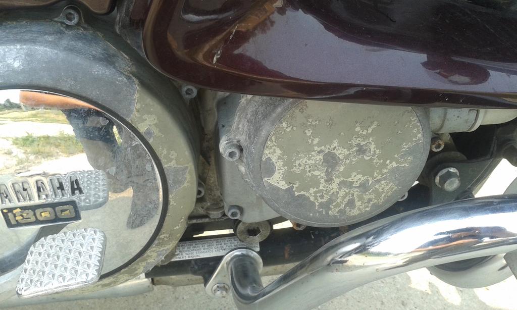

Chaharly Posted April 28, 2017 #1 Posted April 28, 2017 Hey Guys! I got my bike from a guy in Ohio who must've liked to take the bike out on the salty roads in the spring. The polish is corroded off pretty bad, and its looking like some of the painted parts are getting corroded too. I really don't know where to start if I want to have the motor looking half way nice again. I'm considering a repaint some day so I want the motor to look nice too. Some of the corrosion is even on the handlebars!!! I've got a few pics, for your viewing pleasure I've thought about pulling the motor, spraying it silver while covering the polished bits, re polishing them and putting the whole thing back on after a valve adjustment. The problem with that is I honestly have no experience at all about buffing or polishing or even painting really. What would you guys do to make it look better?
bongobobny Posted April 28, 2017 #2 Posted April 28, 2017 Ummmm, buy better-looking ones off of ebay?? As far as what's on the bike, you're in for a whole lot of sanding and polishing to return them to looking good again. You could have them bead blasted and powder coated to any color you think would look good...

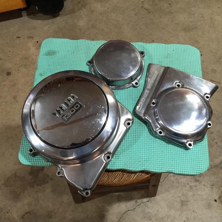

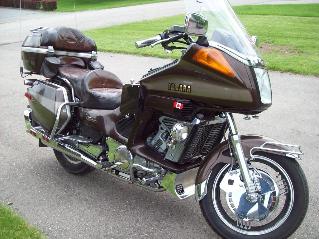

gaj1917 Posted April 28, 2017 #3 Posted April 28, 2017 You can restore most of the tarnished aluminium pieces, but only with a lot of work. For pieces that can be removed, I use an electric bench buffer and various polishing bars. You can get the same results by wet sanding with 600+ grit sandpaper, but with a lot more effort. One you've got a decent finish, coat with a high temp clear finish. Here are examples of pieces I've restored recently.
Chaharly Posted April 29, 2017 Author #4 Posted April 29, 2017 bongobobny said: Ummmm, buy better-looking ones off of ebay?? As far as what's on the bike, you're in for a whole lot of sanding and polishing to return them to looking good again. You could have them bead blasted and powder coated to any color you think would look good... I was thinking about pulling the whole engine, bead blast it and just painting the whole thing at once
Chaharly Posted April 29, 2017 Author #5 Posted April 29, 2017 gaj1917 said: You can restore most of the tarnished aluminium pieces, but only with a lot of work. For pieces that can be removed, I use an electric bench buffer and various polishing bars. You can get the same results by wet sanding with 600+ grit sandpaper, but with a lot more effort. One you've got a decent finish, coat with a high temp clear finish. Here are examples of pieces I've restored recently. http://www.venturerider.org/forum/attachment.php?attachmentid=109087 That looks real, real nice! Any ideas on how to get the gold and black on the clutch cover??
gaj1917 Posted April 29, 2017 #6 Posted April 29, 2017 Chaharly said: That looks real, real nice! Any ideas on how to get the gold and black on the clutch cover?? Paste masking tape across the "Yamaha" letters. Then using an Exacto knife, or similar, cut the tape to expose the inset letters. A tedious job! Spray over the tape and exposed letters with aerosol high temp black. You can do a similar thing with the gold lettering.
Marcarl Posted April 29, 2017 #7 Posted April 29, 2017 The covers and such are doable, but take time to accomplish. First remove all clearcoat with paint remover, then sand with 600 and better, then finally buff with a buffing wheel. I found that a small wheel on my highspeed hand drill clamped into my workmate worked the best, using black buffing compound. I then washed the part and finished it with Classic Cloth. After that it was a yearly cleaning with Classic Cloth to keep things looking good. Never put clear coat on it again. I did all engine covers, forks, floor boards and what ever else wanted to come off. Now your engine don't look so good either. Guess my advise would be to remove it, strip it entirely and then paint the color of choice. Polishing that would be almost impossible.

bongobobny Posted April 29, 2017 #10 Posted April 29, 2017 Chaharly said: I was thinking about pulling the whole engine, bead blast it and just painting the whole thing at onceThat's a lot of work but in the long run probably the most effective!
