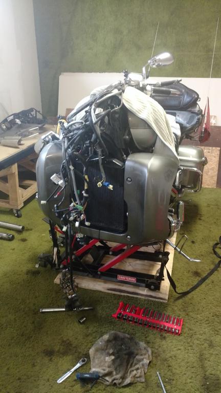

BratmanXj Posted April 3, 2017 Posted April 3, 2017 So I'm finally getting around the my winter repairs & modifications... Front end is off to replace some dented steering head bearings and I'm getting the lower pressed on tomorrow by a buddy. I've searched the forum and not finding how to removed the races. Before I ding something up, can someone well me the "proper" way to get the bearing races out of the neck?

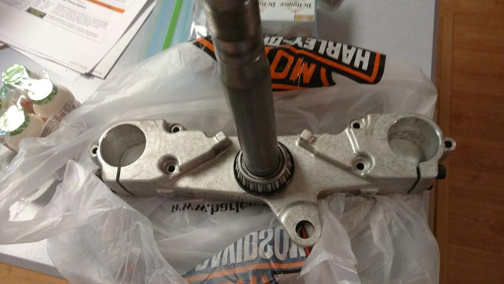

BratmanXj Posted April 3, 2017 Author Posted April 3, 2017 So I'm a bit spoiled when I need machine work. The neighbor where I grew up runs a Harley engine shop out of his house; so my son goes to my mother's on Mondays and I send him with the lower triple. 8:00 AM I get a text from my mother that the new bearing is already pressed on the stem.
Flyinfool Posted April 3, 2017 Posted April 3, 2017 But now it is contaminated, It was wrapped in a Harley bag..........
BratmanXj Posted April 4, 2017 Author Posted April 4, 2017 But now it is contaminated, It was wrapped in a Harley bag.......... Passive Aggressive hints...he makes his living on building some good HD motors, but will be the 1st to admit if you want a bike to hop on and ride you'd better look elsewhere. He has no problem with my Venture or some of the other odds and ends I've made him machine for various Yami's over the years.
