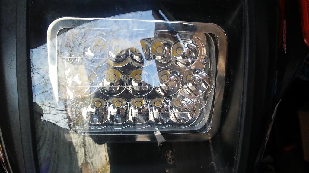

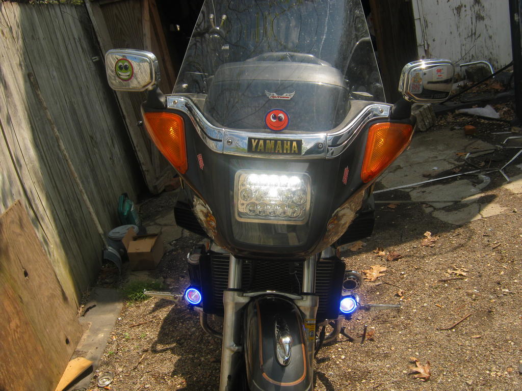

snyper316 Posted April 2, 2017 Author Posted April 2, 2017 Last and Final on My LED endeavor I added a headlight after finding a mounting frame for the venture so I could hack it up if needed, Had to hack it up I will put finishing touches on it later, Talked to @Flyinfool one night in chat and was talking about the MK1 headlight setup, Honestly it sucked no matter how hard I tried all I seemed to get was crappy lighting. I don't know about any of you but if I am gonna be on 2 wheels I want to see at night and be seen... which is why I have added all the stuff to this bike for better visibility and to be heard if need be. Gotta love them people who think there cars are there home or offices!! So I bought this bulb off of ebay and went to hacking away at the frame. I also bought a little longer screws for the headlight frame to hold it in. . I can always go back to Silverstar light if I don't like this. Now to get back out and see where that darned wheel has ran off to this time!!
Flyinfool Posted April 2, 2017 Posted April 2, 2017 Interesting So how is the beam pattern and the cutoff? How is the visibility at night.
snyper316 Posted April 2, 2017 Author Posted April 2, 2017 Interesting So how is the beam pattern and the cutoff? How is the visibility at night. Well I haven't had a chance its other been raining cold or too much roadlight... I want dark road to try it out and I know of one that I can go down and adjust the beam and get it dialed in. So far the light spread seams better. Sent from my LG-K371 using Tapatalk
bongobobny Posted April 3, 2017 Posted April 3, 2017 OK the very ext thing you want to do is buy yourself some white paint that sticks to rubber, and paint that black rubber bezel around the headlight white!! You will be amazed at the difference it makes!!! White reflects light, black absorbs it...
snyper316 Posted April 3, 2017 Author Posted April 3, 2017 OK the very ext thing you want to do is buy yourself some white paint that sticks to rubber, and paint that black rubber bezel around the headlight white!! You will be amazed at the difference it makes!!! White reflects light, black absorbs it... You know this thought has crossed my mind many of times. I could never figure out why they did not use white rubber there. I guess my question would be where do I find that? I was even thinking about lining that rubber with aluminum...
