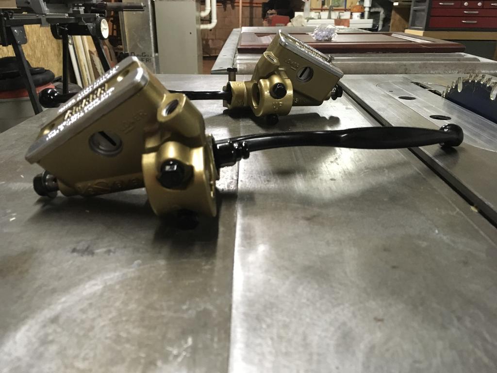

bongobobny Posted December 31, 2016 Posted December 31, 2016 Good job!! I take it your '83 is a blonde...
Yammer Dan Posted December 31, 2016 Posted December 31, 2016 Good job!! I take it your '83 is a blonde... Or will be!! How many blondes are real?? Well maybe more in this case than that other:innocent-emoticon: Does the rest look that good??
bongobobny Posted December 31, 2016 Posted December 31, 2016 Hey Dan, what do you call a brunette that dyes her hair blonde??? Answer: Artificial Intelligence...

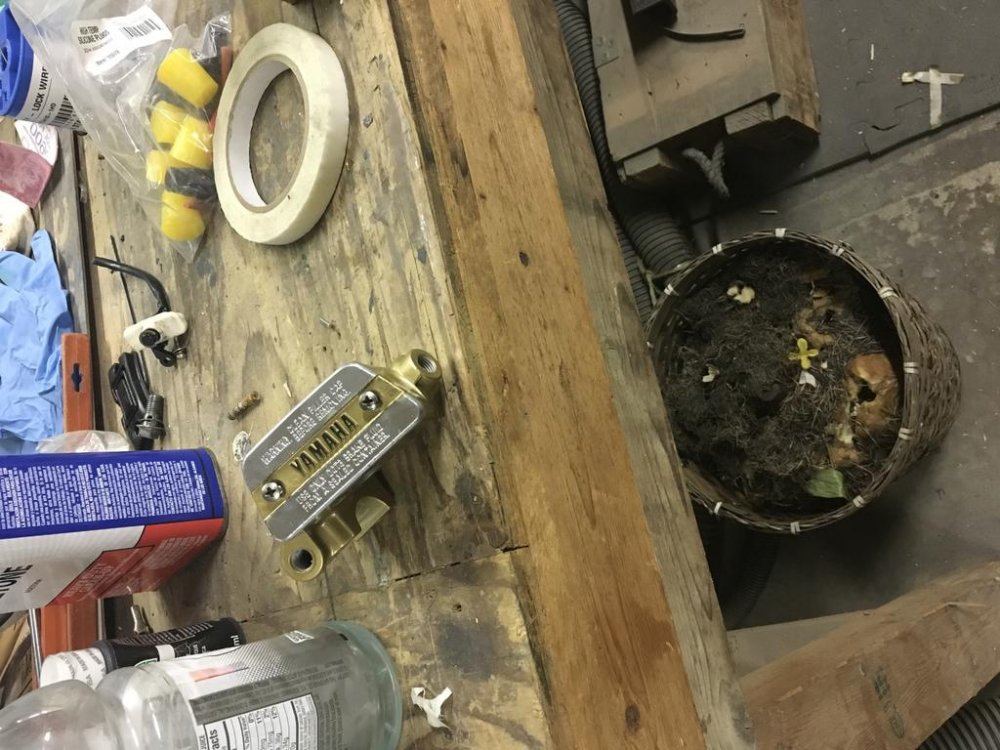

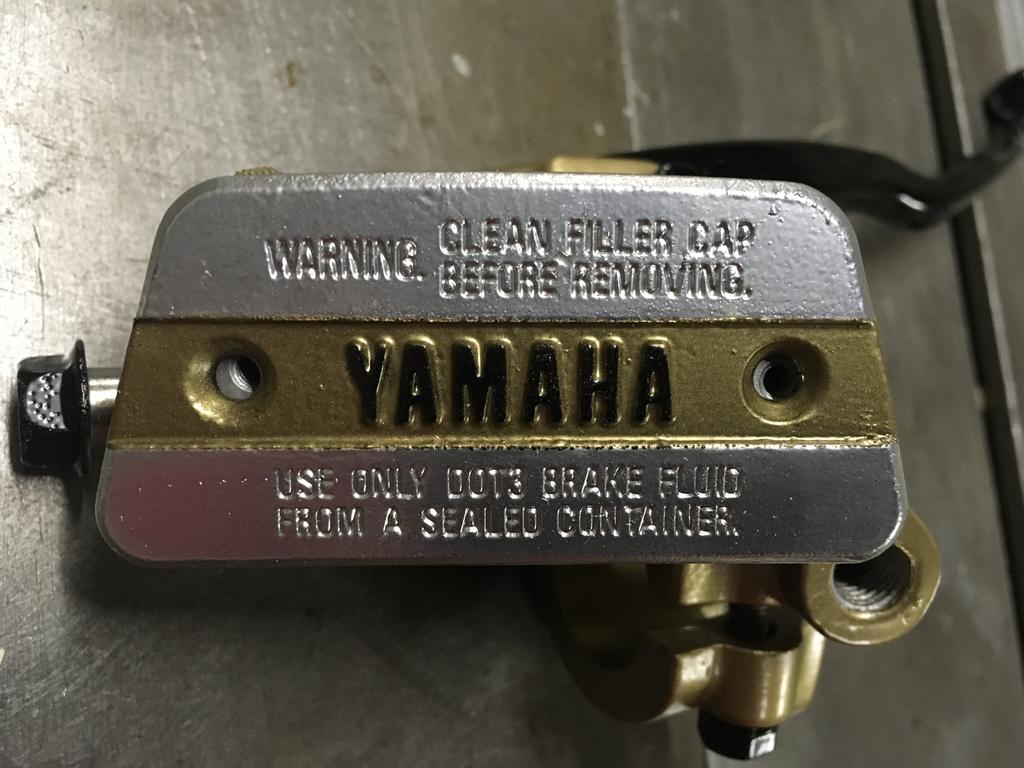

Bassett Posted December 31, 2016 Author Posted December 31, 2016 does anyone have sight glasses for these? if not, ok i know where to get them.

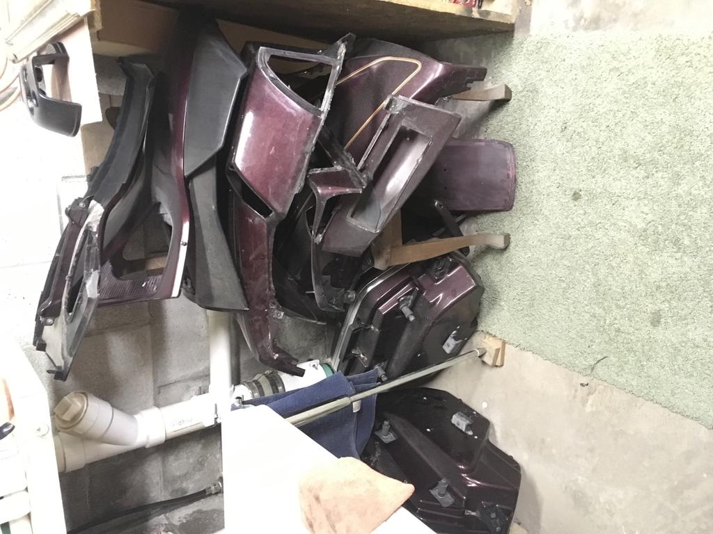

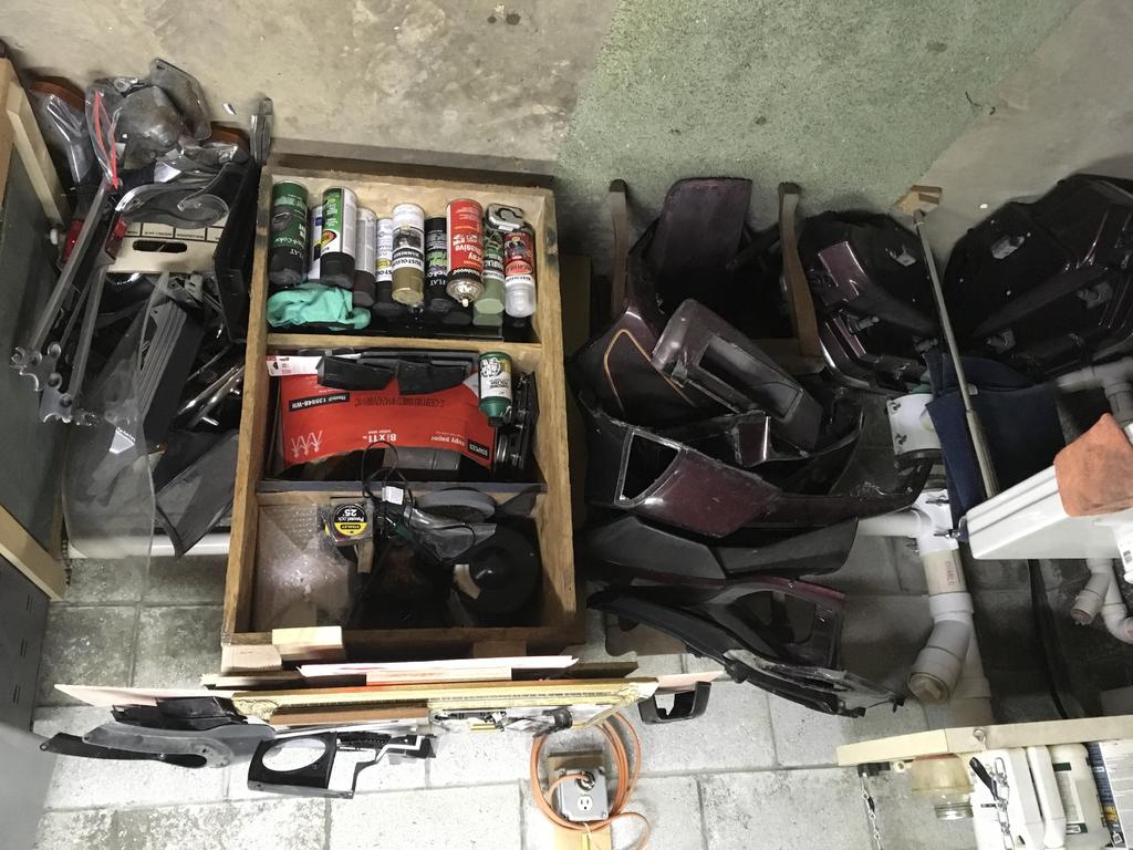

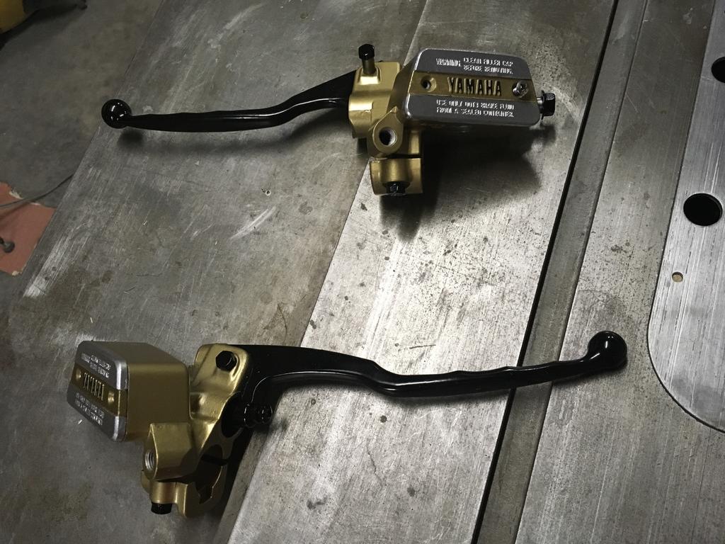

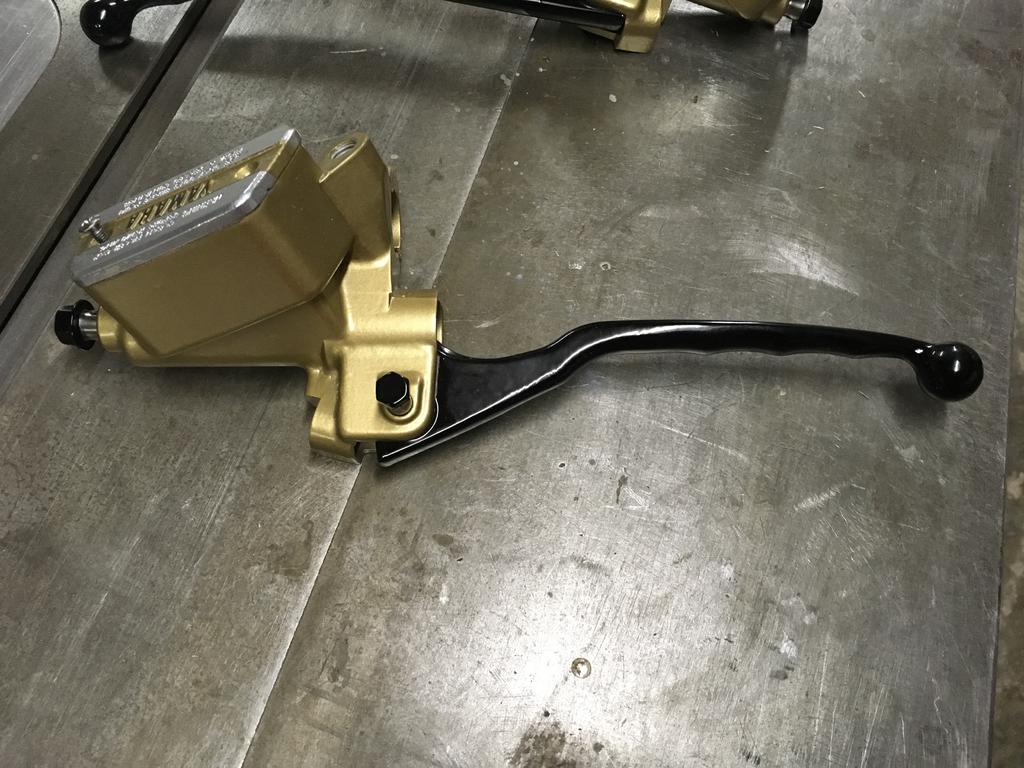

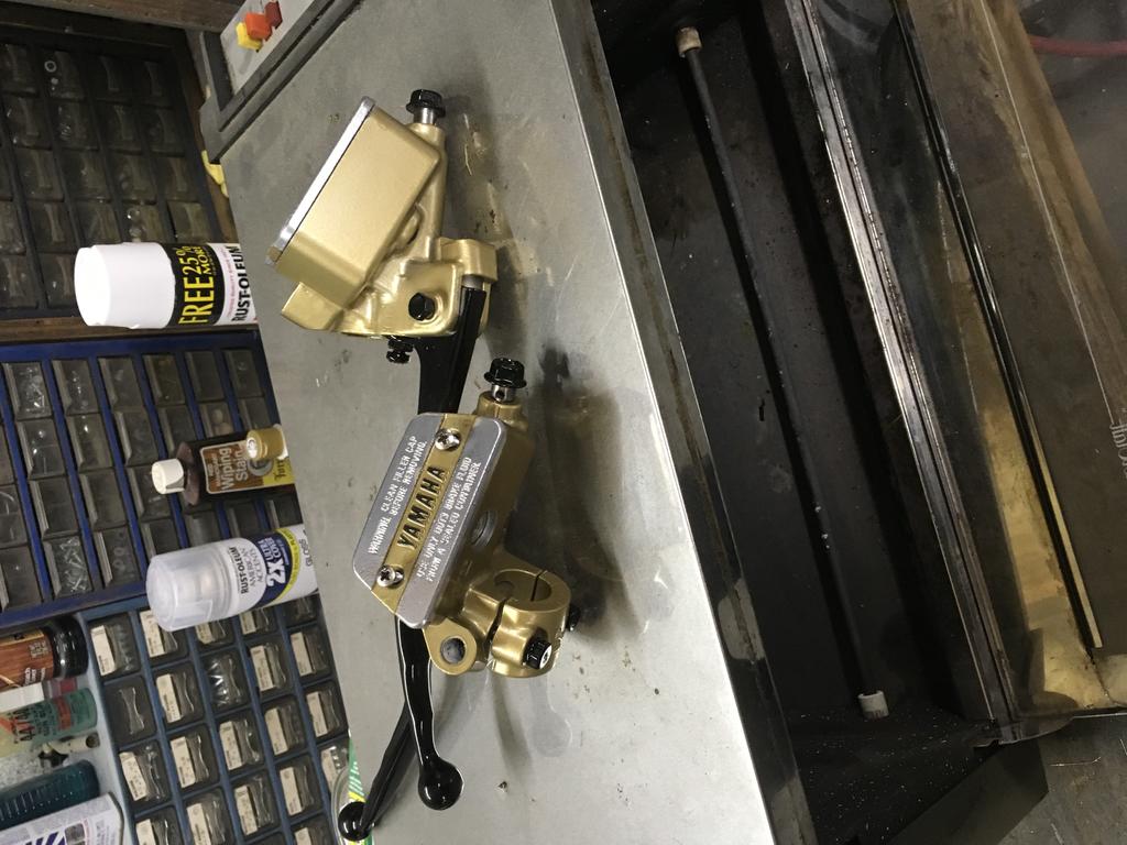

Bassett Posted December 31, 2016 Author Posted December 31, 2016 (sorry one picture is upside down!!) Ok, so my bike is under construction right now. I have finished the plastic repairs, and I will be priming for paint shortly. My trim pieces and vents are painted. All my chrome is polished. Still working on getting my one side case open. Today was re-finishing my master cylinders.. They're not ready to install yet on the bike because I am waiting on sight glasses, and the one company sent me a clutch master rebuild instead of a brake master, so I have to get that squared away after the new year. next steps will be: - priming for paint -painting (black cherry pearl) -refinishing/rebuilding forks. -rebuilding slave cylinder -frame/engine recondition/tune up -installing new tires and battery - putting it all back together!!! Maybe I'll throw a Bike Party and get some help for the last couple of things for time's sake. -Alex
snyper316 Posted January 1, 2017 Posted January 1, 2017 Ok I just have to ask what is this powder you are speaking of? How do you replace the site glass I would love to do that with mine so I can see my levels without removing the lid.
Yammer Dan Posted January 1, 2017 Posted January 1, 2017 I've seen several threads on the sight glasses. Do a search on them. Should be places to buy them included in those. Those masters sure look good.
videoarizona Posted January 1, 2017 Posted January 1, 2017 Well done! Wish I could do that. Really adds a nice look.
Bassett Posted January 3, 2017 Author Posted January 3, 2017 Ok I just have to ask what is this powder you are speaking of? How do you replace the site glass I would love to do that with mine so I can see my levels without removing the lid. Powercoat is a type of coating that that is applied in powder form then cooked to achieve a strong, durable, smooth finish. Sight glasses- 17.5mm diameter x 2.5mm thick. Best is from a watchmaker who will give you glass.. hope that helps! Anyone near me want their master cylinders, lower forks, brake calipers, or any other odd or end powdercoated I have a wide range of colors avaiable if you're interested!
Bassett Posted January 3, 2017 Author Posted January 3, 2017 I've seen several threads on the sight glasses. Do a search on them. Should be places to buy them included in those. Those masters sure look good. Thanks! Very happy with the results.
snyper316 Posted January 3, 2017 Posted January 3, 2017 Powercoat is a type of coating that that is applied in powder form then cooked to achieve a strong, durable, smooth finish. Sight glasses- 17.5mm diameter x 2.5mm thick. Best is from a watchmaker who will give you glass.. hope that helps! Anyone near me want their master cylinders, lower forks, brake calipers, or any other odd or end powdercoated I have a wide range of colors avaiable if you're interested! Umm I was thinking powder blasting lol I used to powder coat things and yes very durable I hated rework.... Living life one curve after the other. Vroom scooting, thru the countryside.
