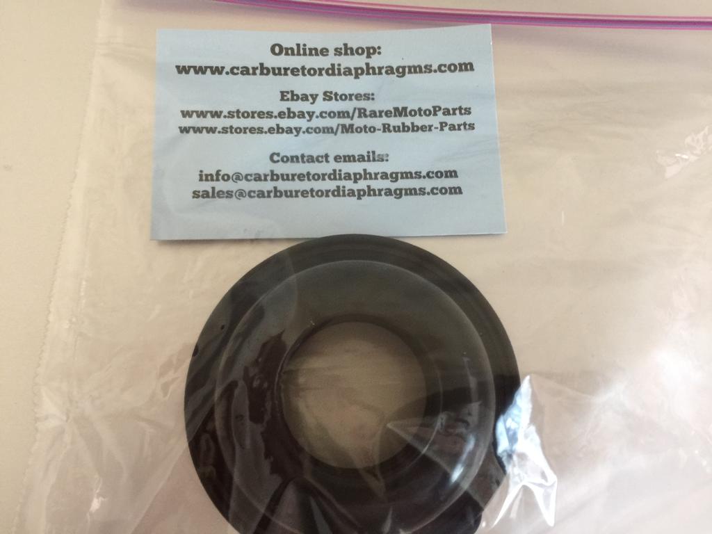

CaseyJ955 Posted October 30, 2016 Posted October 30, 2016 I'm prepared for my Permatex fix not to work, if it fails I'll replace all 4 diaphragms. Has anyone had any experience with this seller or his product. He said he manufactures them and that they are not from China. Price is attractive to be sure. I'm not good with OEM prices and would love a quality alternative. Does this look like such an alternative? Any info apriciated. http://www.ebay.com/itm/281761118293?euid=596e8d8aea814f2e9c2fcccb64a04c8c&bu=43133956111&cp=1&sojTags=bu=bu
VanRiver Posted October 30, 2016 Posted October 30, 2016 Hi CaseyJ955, Yes I bought 2 sets off this Ebay seller back in February of this year (2016). I paid $79.23 (each set) including shipping to Canada back then. They are good quality and fit well, I have one set installed and the other sitting here on my desk, so if you want a "Real" picture I can send them to you. The seller is also a good guy, I had some shipping problems as they took FOREVER to arrive from the UK to Canada, but he was very helpful and responsive during the process. Let me know if you need any additional info or pics. I'm prepared for my Permatex fix not to work, if it fails I'll replace all 4 diaphragms. Has anyone had any experience with this seller or his product. He said he manufactures them and that they are not from China. Price is attractive to be sure. I'm not good with OEM prices and would love a quality alternative. Does this look like such an alternative? Any info apriciated. http://www.ebay.com/itm/281761118293?euid=596e8d8aea814f2e9c2fcccb64a04c8c&bu=43133956111&cp=1&sojTags=bu=bu
CaseyJ955 Posted October 30, 2016 Author Posted October 30, 2016 Hi CaseyJ955, Yes I bought 2 sets off this Ebay seller back in February of this year (2016). I paid $79.23 (each set) including shipping to Canada back then. They are good quality and fit well, I have one set installed and the other sitting here on my desk, so if you want a "Real" picture I can send them to you. The seller is also a good guy, I had some shipping problems as they took FOREVER to arrive from the UK to Canada, but he was very helpful and responsive during the process. Let me know if you need any additional info or pics. That will do it. I'm going to go through everything and make sure there are no other issues keeping the carbs funky, then I'm either going to order the diaphragms or break out my wirefeed and start making a 2bbl intake modeled after what PKR just did. I'm glad to know the diaphragms are of quality, the guy was quick to answer my questions but I'm apprehensive by default. Thanks for taking the time to let me know about those.
VanRiver Posted October 30, 2016 Posted October 30, 2016 Here is a pic of my extra set purchased from this guy.....and the business card that was included in the shipment from this eBay seller: Also if you are looking for another source to buy from I have purchased them from these guys as well: http://www.siriusconinc.com/pro-detail.php?pid=&product_id=1794 I believe if you call or email them and tell them you are "VentureRider" member they will give you an additional discount. The last I bought from them they cost me $79 with the discount included back in 2014.
