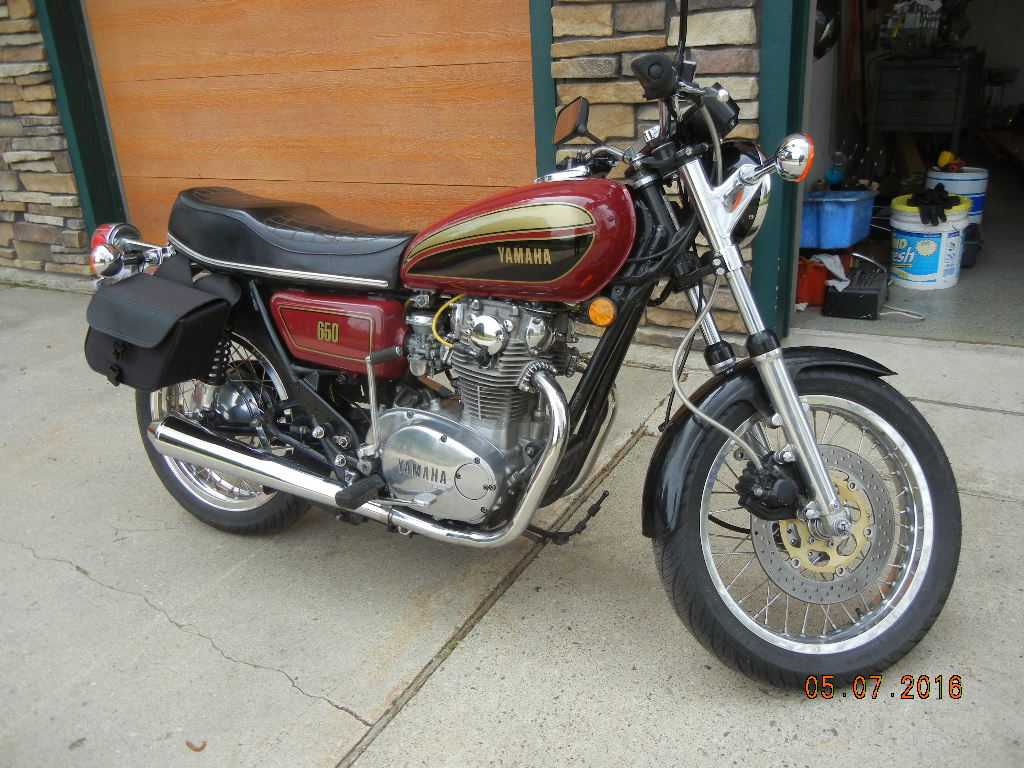

tntviper1 Posted September 16, 2016 Posted September 16, 2016 did a search (my new tag line) what is the best tool (dremel?) to polish all the metal on my new venture? i want to do the covers and pipes etc over the winter. chrome isnt the issue the stuff shown is what i want to gleam like a mirror

gggGary Posted September 16, 2016 Posted September 16, 2016 (edited) first strip the clear with paint stripper (the nasty stuff) ventilate, skin protection. Dico wheels are are much better than sand paper especially for complex shapes, they come in three "grits" Gray 80 Orange 120 Blue 240 https://www.amazon.com/Dico-541-784-4-Nyalox-Wheel-4-Inch/dp/B00004YYD9 I like a 4" wheel, chucked in a variable speed electric drill, start with a blue. the others work for deep corrosion but the scratches they make are deep also. You have to be a bit careful they can round off sharp edges. Then black buffing compound on a sisal wheel. wipe part with rag or paper towel and mineral spirits the grit in the buff is held in a wax base the mineral spirits removes the wax and coarse grit finish with white compound on a cotton buff. repeat wipe with mineral spirits. If you are doing alot a bench or pedistal buffer minimum 3/4 horse. wear face and breathinng protection. this is messy work. This will get you to a finish that will wow em for all but "show quality" work. 40 year old "barn find" after a little "rubbing" Edited September 16, 2016 by gggGary
SilvrT Posted September 16, 2016 Posted September 16, 2016 While gggGary 's method is probably a more "professional" approach, I simply mounted a buffing wheel on my electric drill, stuck it in the vise (it's case is designed for that), locked it in full speed and used Solval Autosol. I took each piece off the engine, cleaned off the clear coating, and went at it with the buffing wheel using liberal amounts of the Autosol, taking care not to "burn" the stuff. After a good "buffing" with that I'd change to a clean buffing wheel and polish off any Autosol film left. My engine covers came out like chrome. That was my procedure in a "nutshell"; however, this takes some practice and I've had lots before I tackled my '85. Buffing Wheel
tntviper1 Posted September 16, 2016 Author Posted September 16, 2016 GEEZ ggary that looks like it just came from the dealer, nice job thx guys i will be doing this over the winter, i think she needs paint too
